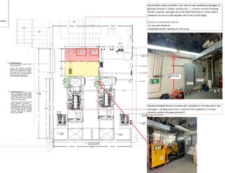

I'm an electrical engineer in training so please bear with me.
Basically, a bank has ordered a second 500kw diesel generator and my job is to design the infrastructure to allow them to run simultaneously. It has been suggested that a "Paralleling switchgear" be used that could potentially house both Transfer Switches and possibly both the generator breaker panels that must be removed and operated remotely due to clearance code requirements. There's also a fire pump Automatic Transfer Switch that must remain.
Specifically:
1. What infrastructure is needed to tie the new generator into the system other than an Automatic Transfer Switch?
2. Is a "Parallelling Switchgear" a viable option?
3. There is a basement UPS room with space to house any other equipment, is this my best option?
4. Code wise, can the Generator breaker panels be housed in the same switchgear?
5. Could the fire pump ATS go in the switchgear also?
The Client wants to be able to present an updated pricing to the banks board August 31st.
I would appreciate any feedback

Hey James,
Thank you for the quick response. I left out key information that this is an additional generator being tied into an existing system. What I need to know is the how to integrate the new equipment needed and the existing equipment into the limited space that is remaining in the generator room.
I.E I cant just add another ATS in the room as code requires specific spacing.
As I suggested before, this is a complex installation that needs some proper design from people that have all the information.
you are unlikely to get a suitable system designed for you on an internet forum.
