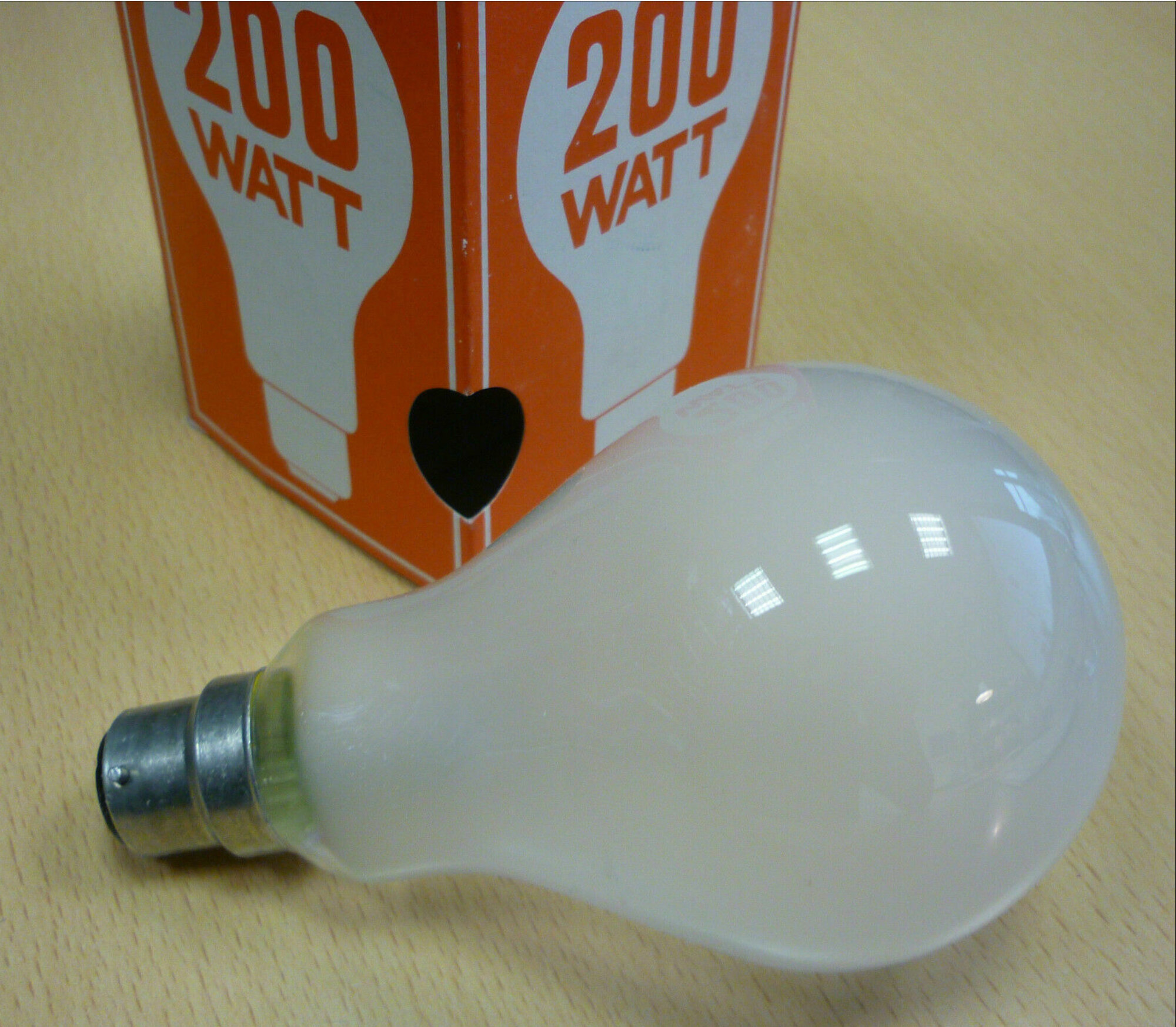

I obtained some "200 Watt equivalent" LED bayonet bulbs, and been impressed with the light output. Not sure about the 'equivalence', but they are certainly brighter than a 100W filament bulb, and run cool. Prefer 'warm white' myself!
Not recommending any particular brand, and you take pot luck with how long they last, but they do chuck out the light:

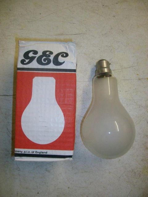

These 150W babys were hot.
