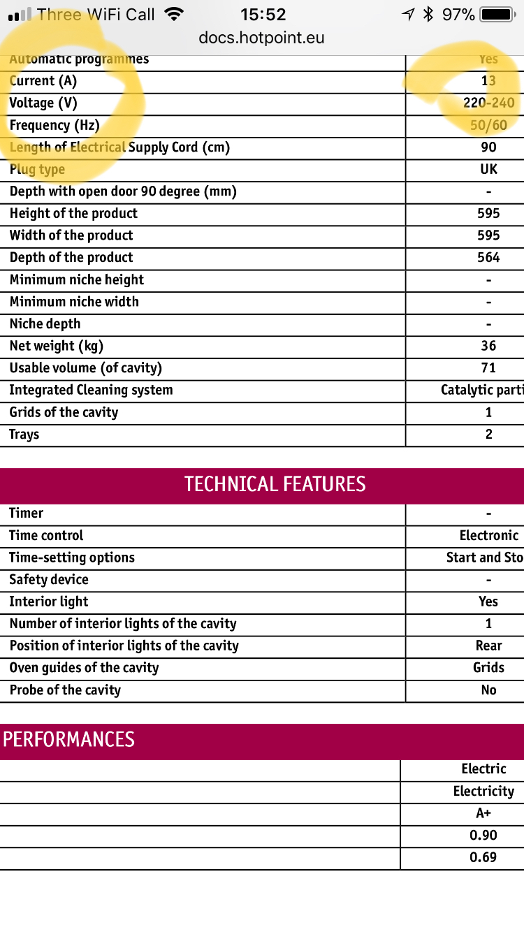

We have a new Hotpoint oven to install SI4 854 PIX. Old oven was 2.8kW Neff hard wired into dedicated circuit with its own breaker switch on wall. However, new oven, with pyrolytic cleaner, is 3.65 kW, rated but comes with 13Amp plug and lighter gauge wiring. I was going to plug in myself but clearly I need a sparky to convert hard wired socket to plug socket. However, in any case, this seems wrong - surely this requires 16A fuse and heavier duty wiring?

Data sheet says max current 13A. Where did the 3.65kW come from?

The 13 Amp fuse is there to protect the cable not the cooker circuit.
Your cooker/oven should have a breaker in the CU.

When i say cable ,i mean the cooker cable.
As @LeeH has pointed out. I can't find 3.65kW in any of the specs.
I suspect that figure comes from the rating label on the appliance. Seems all these manufactures don't want to get involved in the cabling for these appliances 'if in doubt, speak to a qualified electrician'!

View attachment 41256 Data sheet says max current 13A. Where did the 3.65kW come from?
3.65kW is on label on packaging and also on sticker inside oven.
I have meanwhile phoned Hotpoint and although the support phone people were agreeable they knew nothing. They did however contact their tech people who replied, as another forum response indicated, that 3.65 kW is total load from all oven functions, but since this is an impossible scenario 3.65kW is never drawn at ay one time, and so 13A is fine. So seems all ok. BUT, I have to wonder ... what's the purpose of the 3.65kW rating? Surely a max possible kW would be more useful?

Think you may have been fobbed off
The Rating plate should indicate what the power of the cooker is, to say it was on the packing, may be true, but the plate should have indicated that as well.
