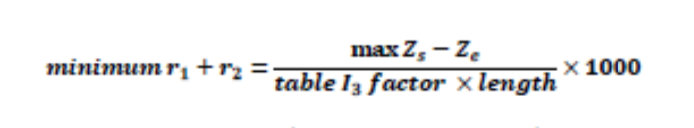

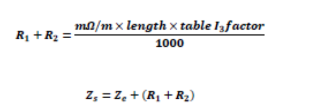

The first equation I cannot follow. Surely it should be maximum R1+R2 (not r1+r2) per metre in milliohms.
The calculation is working backward to give you the figure to cross reference in table I1. Zs - Ze is the total circuit resistance, Ω, at normal operating temperature, dividing by length gives you resistance,Ω, per metre, dividing by the table I3 multiplier gives you resistance, Ω, per metre at 20°C and multiplying by 1000 gives the maximum resistance, mΩ, per metre at 20°C. So any value in the table lower than your result should be compliant.
The second equation is what you have already been doing to get your calculated Zs.

Thanks Richard. The maximum r1+r2 is a strange one. There is a calculation in the book
Method is B I must of read something else.
1.37-0.24/1.2*18* 1000 = 52.31m ohms/metre.
Mine for some reason is very high. Also the Calculated Zs should that be Ze 0.11 and R1 and R2 are 7.41 total is 14.93
Would that be correct?
Come on, remember what units you are working in at each stage.
The calculation you show but do not explain seems to show
Zs - Ze (1.37-0.24)
Adjust for temperature (1.2) as a divisor goes from 70°C to 20°C
Circuit length m (18) as a divisor give a value per m
Ω to mΩ (1000) as a multiplier to give a result in mΩ/m @20°C
So take the BS7671 max Zs for your breaker subtract Ze divide by 1.2 divide by circuit length multiply by 1000 to give mΩ/m @20°C.
i.e. the number you would look up in table I1 for the 2.5 line 2.5 cpc row value to check if the cable you want to use has a lower resistance.
In your case the circuit is short and the cable is very much lower resistance than the 182mΩ/m that you would get so in that instance a cable could be 12 times longer (144m) before you came close to exceeding the maximum Zs, though the volt drop would limit the length of the circuit more.
For the calculated Zs=Ze +(R1+R2)
Your Ze is 0.11Ω, your calculated value of R1+R2 for the cable you have chosen is in your calculation list "Calculated R1+R2 = 7.41+7.41x1.2x12/1000 = 0.11Ω"

The calculation above is out of a book we were given it’s to find the maximum R1+ R2 to determine the size of the CPC.
Calculation are
Maximum Zs -Ze / I3 factor x length overall x 1000
So you then add your Ze to that value to get your Zs.

I think you are missing a key point
Look at this calculation you typed
  • Max R1+R2 2.73-0.11/1.2x12 = 181.94Ω
And compare it to these that you typed
What is the (small but important) difference?
I can only work from what you post and if there are assumptions or specifics that are not mentioned or are changed I cannot work from these.
I have been trying to provide enough information to allow you to calculate the answers based on the normal approaches, however the training approach is not quite the same. Where things appear to vary from what I expect I have queried them or tried to work out what you have meant, not necessarily very successfully.
I have prepared the attached calculations that I think should provide the answers that you have been asked to find.
I am now falling behind on my paperwork so will have to reduce the responses I am making.
Thanks Richard. The above has helped. In the calculation I posted above I forgot to include the x 1000 to get the m ohms per meter.
I also see how it’s broken. That’s much better and easier to follow. Is that a program you are using? Or is it something you have put together?
Well done on the error, it is vital to be able to spot these (and correct them)
The diagram and equations are something I have just written/drawn out to provide a total overview.
