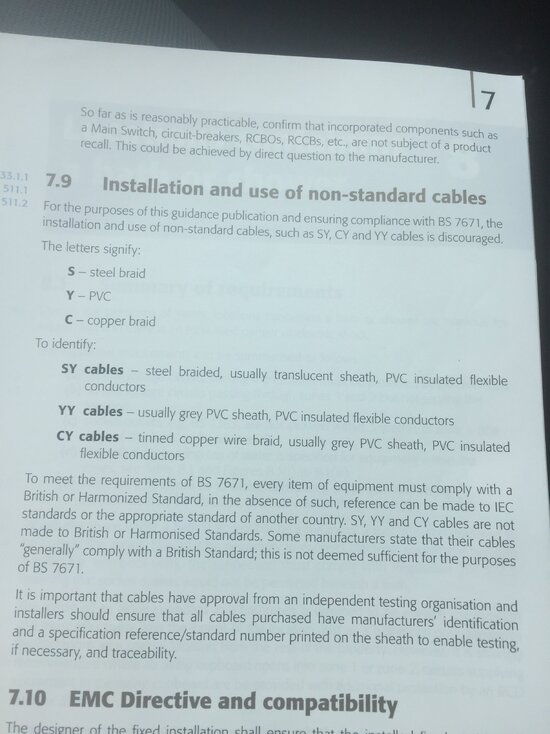

can anybody tell me what size sy cable I need for a 25kv 3 phase temp generator please to power a 3 phase machine lathe
Hi mate.
Show us your calcs for the cable size and we can confirm that they are right, if you want.
36 amps load current per phase so go from there.
I've no idea the ccc of sy as it's not recognised in bs7671 as it's classed as a non British standard cable But most manufacturers claim it's to bs en 50525-2-11
Why SY cable mate? Have I missed something?

They do a cy type with pur coating and it is even tougher but is shielded
