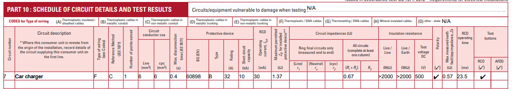

Thanks for the very prompt response Julie.
I attach the extract from the certificate for the existing installation so I don't know if that helps.
I am not too concerned because it has been working without any problems so far, but I can understand that the charger will be called upon to operate at max 7kW load for approx 5 hours every 1 or 2 days for many years to come and therefore its circuit/breaker will be 'challenged' more than any other in the house. So, if considered prudent, I could get an electrician to change the breaker to 40A.
The existing arrangement must be compliant so perhaps it's a 'personal preference' consideration (but of course taking into account your points if I decide to uprate).

That Zs should be fine for a 40A mcb, however it still doesn't mean it would be ok to change.
A 6mm^2 cable, depending upon the type and installation method may not be capable of carrying 40A.

Also fyi the cable type installed is ‘F’ so swa (steel wire armoured) with an installation method C (clipped direct) so therefore cable capable in this situation of safely pulling 53amps. So 40 amp breaker would be fine 👍
I don't quite trust reports or EIs with installation methods, it's virtually impossible for the same method to be used all the way through the installation of a particular circuit.
It's usually a combination of clipped direct over most of it, a bit through duct/conduit and a bit behind insulation (thermal) etc - only the installer truly knows if the C is true in it's entirely, or just mostly true (and what the non-true bits are).
