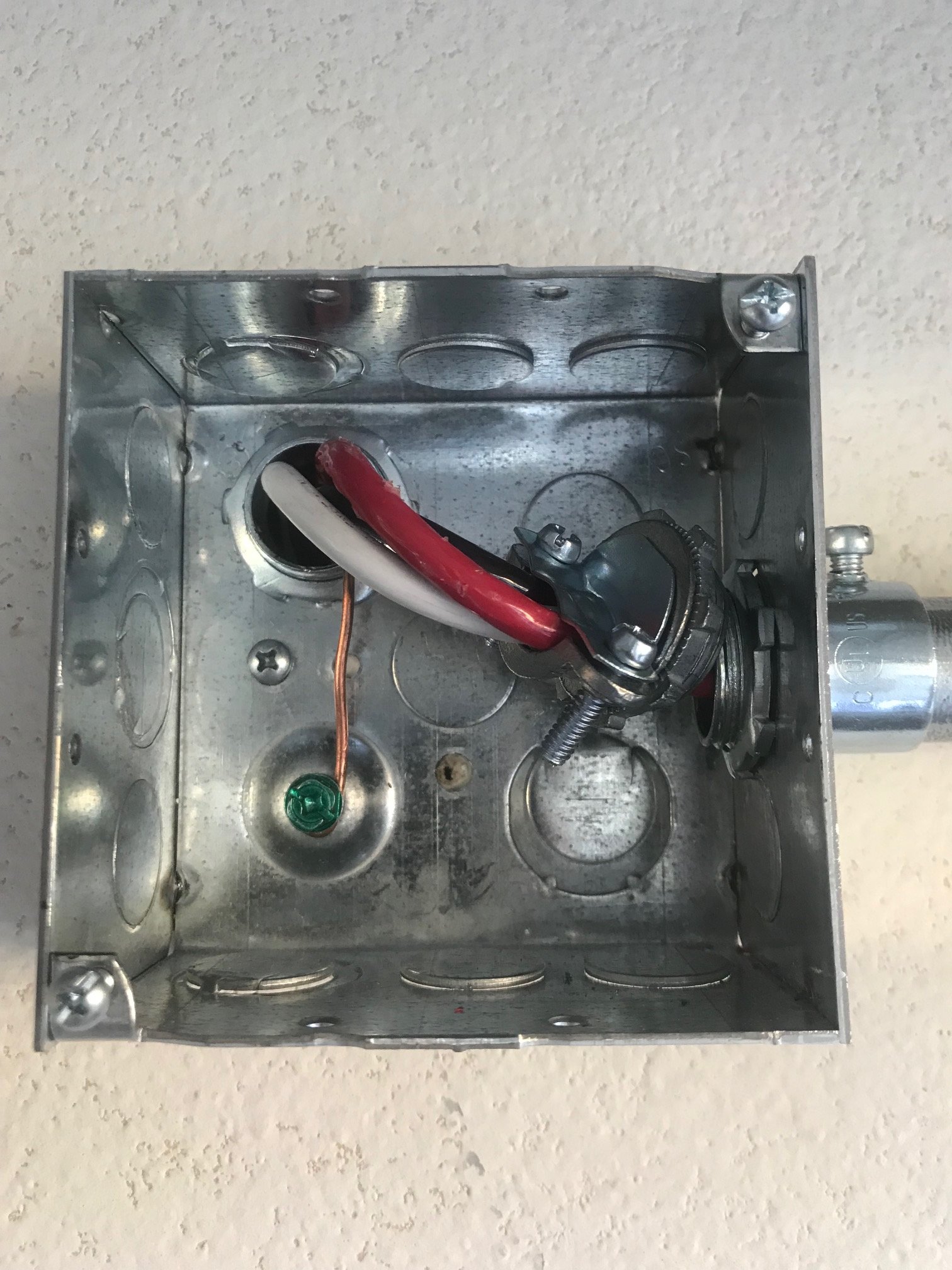

Just got other one done today. It is a 6/3 wires. No neutral wire needed for this EV charger. Two hots, 240V, 50 amps breaker, grounded on electrical box. Ground wire in white, HD ran out of 6 gauge wire in green so I used white. Please advise if I need any improvement on anything.
Extra clamp in the electrical box to prevent from pulling. But I think I will take it out b/c I don't thing it will be any pulling.
Second pic is showing on top of breaker box with a punched hole with 1 3/4" plastic snap-in bushing.
Tony do me a favor and take that connector out of that 4 inch square box

Tony also tape up that white wire with black tape if you don’t it is a code violation, otherwise good job and I’m proud of you

Thank you. I will do it today and will post more pictures. May I ask, what is the meaning of white wire with black tape in code?

If you are using a white wire for any thing but the neutral it’s needs identification so people don’t think it’s a neutral when it’s actually got power on it

I hate to tell you this but you said that the charger didn’t need a neutral so to stay in compliance with the NEC it needs to be taped green other than that good job
