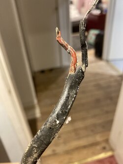

The black rubber cable doesnt sound right... Is there any chance you could photgraph what you see and post here?

Attached is a pic of some off cuts of the cable in the loft. Where it comes up it’s only black and red. And at the consumer unit there’s no rcd.

Is that the cut off from the feed cable from the CU?
Assuming so yes. The cable comes through the cavity into the loft then about 2m across the loft space before entering the green 4way connector block. Then new twin and earth does all the rooms. There’s all sorts of lengths of this up here. Chopped up. Some just L and N and other bits line-switched line
As above, if it were me I would not be re-energising that circuit until you have had an electrician in. judging by the state of that cable if the rubber cables are still in service, its going to need rewiring, am surprised when you purchased the property that they didnt recommend a condition report of the installation?.
