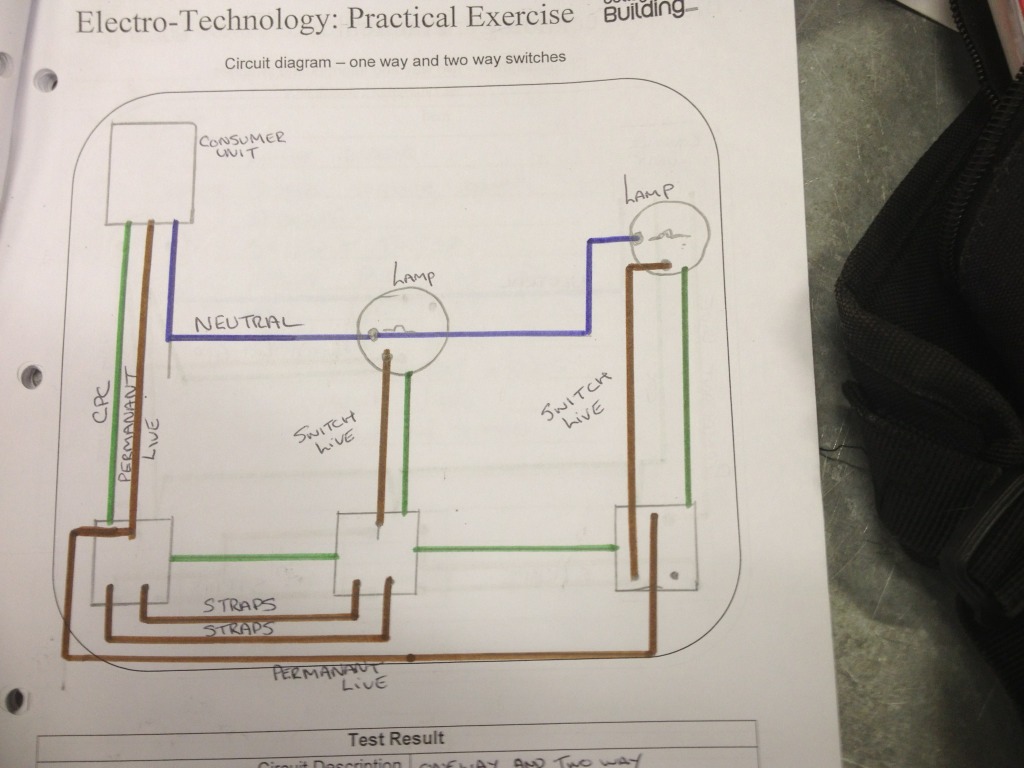

ImageUploadedByTapatalk1388425554.107841.jpgIs this the sort of design you are speaking of because the customer will say where they want the lights??

Post #6, no we are not going as far as that mate. You should be able to do a diagram in your head, if needed put it down on paper for reference. Stop looking into things ttttooooo far ahead. This is not an exam, just experience.
Hahaha it's what happens when u have my slightly nervous, all the questions I have I want answering NOW :) k mate ill wait for confirmation as to when it is, a weekend is not a problem, just remember monday and wednesday im at college at 6pm, guess I'm just worried about letting u down, I'll look forward to this
that picture was from my college work just wondered if thats what you sparkys draw down when you said to design it or you meant where to put the lights, since i dont know what a design entails i was curious

This is what your trying to achieve, being a full time Electrician. You will be doing things like this on a daily basis. Dont let things like this phase you, its only wires coming from a big box going to a smaller box via a mcb and switch. Everything else is ELECTRICS!
Hope your going to put a CPC with that Neutral? It is a Line conductor after all lol. Only pulling your lg mate :wink:

unless, physically, that neutral runs through the conduit in such a way that there is already a cpc running along with it (and other cables).
I have'nt forgot about this, I be in touch with you. Been very busy with other things.
You trying to catch me mate :)
Like tel says which you probably already knew it went through the conduit with other cables, that's just how we have been down to draw it
It was just a piece of conduit running from the CU to the light with 2 pieces dropping down to each switch
