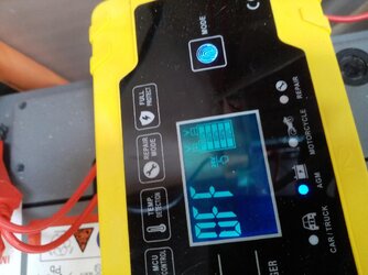

Hi Sinewov, i am more of an optimist and see any power harvested during the day is beneficially positive.
As i mentioned in my post the charging automatically kicks in if the battery voltage drops, The 24 volt chargers are auto sensing the required charge input and only put in the amount of charge needed to keep the inverter operational, in essence if i turn on the TV/Audio and the Freezer kicks in and all the lights are switched on and if the panels provide enough energy the chargers are OFF But if the sky goes Dark Black and the voltage drops only then do the chargers automatically sense the voltage drop and kick in its only then the chargers automatically provide just enough charge input to keep the voltage steady, its not a Charge Up/Discharge System, so in essence when i check the system it can have 200 watts from the solar panel and 50 watts fluctuating from the chargers.
At night it will drop to a trickle charge and switch off charging.

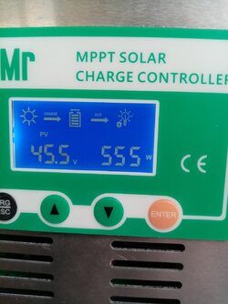

Just been out to check the Solar Stuff and at 9.55 its kicking out 501 watts topping at 555 watts, Batteries are charging and Everything in the Bungalow is running Off Solar, Happy Days :)
It maybe your workmate has bought a cheap solar panel and a basic controller and inverter using duff forklift truck batteries, all i will say is i a retired electrical engineer and spent 2 months doing the maths and finding the correct panels, MPPT controller, auto chargers and batteries, the system had to be as low cost as possible but still function and save energy costs. Best Regards RBS
Some pics 🙂

This system works for me 😉 Regards RBS
