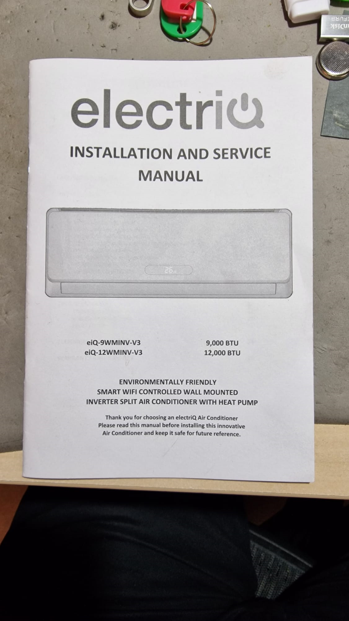

I assisted a friend in installing a wall-mounted AC system in his house last year. It was a simple job, and the pre-finished pipework was easy to connect. No need for a special engineer as it was pre-charged with either propenae or butane as the refrigerant. He reported to me this morning that it is coping admirably in the current hot weather. I must say i was impressed with the overall quality of both the inside and outside units, but of course, with pre-formed pipework it's important to get youe distances correct. He bought the unit from aircondirect.co.uk and here is a shot of the manual. I believe it was the 12,ooo unit we installed.

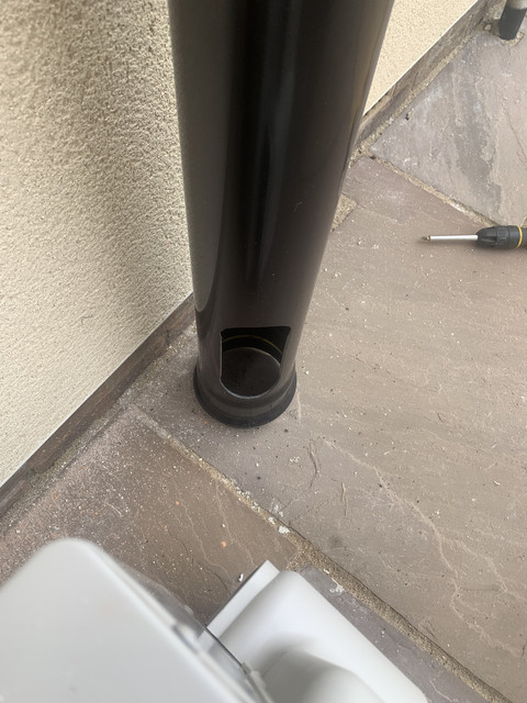

Crap, totally forgot about the condensate but I can get a little diaphragm pump from work. It cannot go on the outside unfortunately.
I intend to install the pipework through some soil pipe to match the downpipes/vent pipe so can run a flexi down that.
