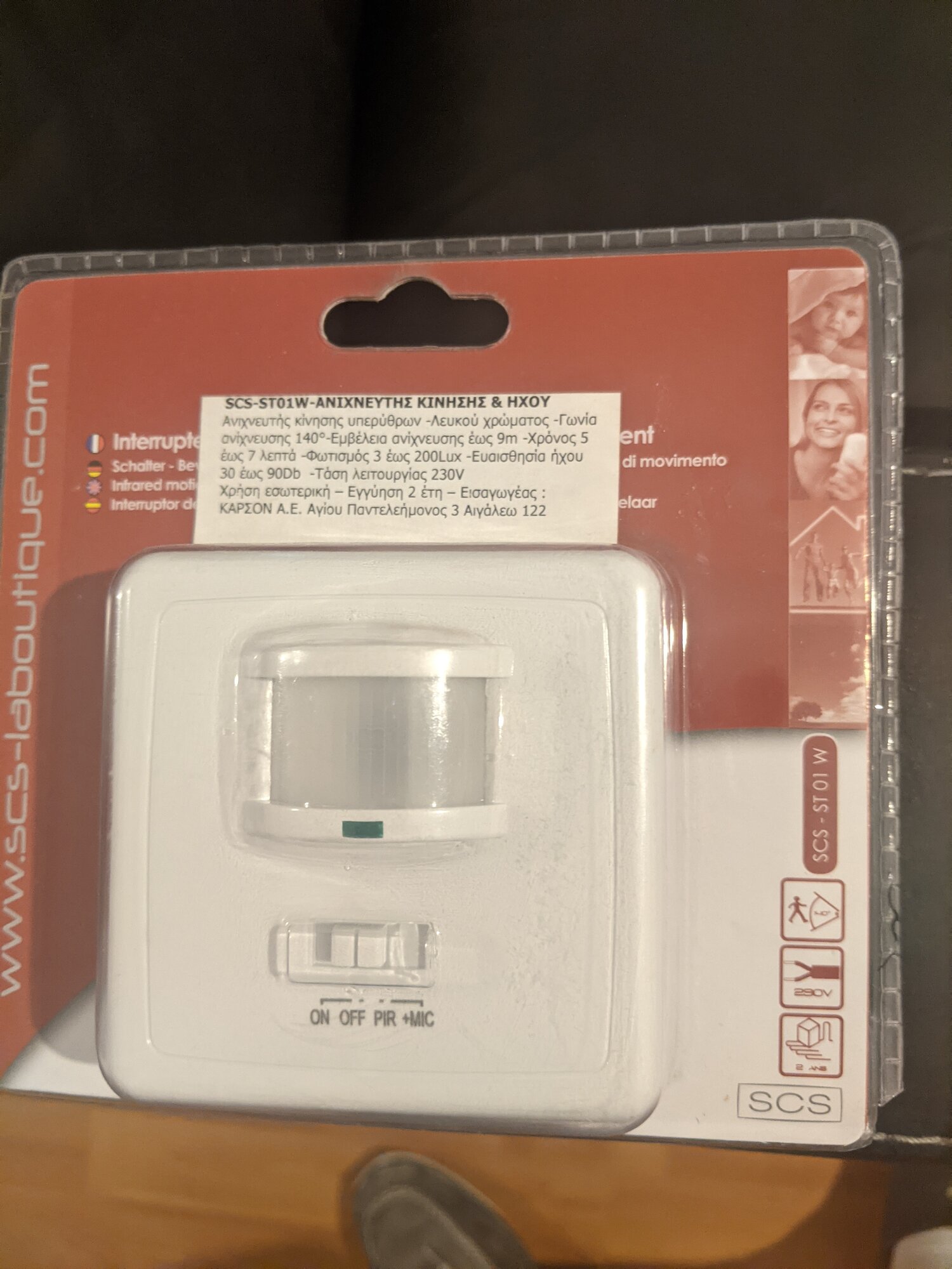

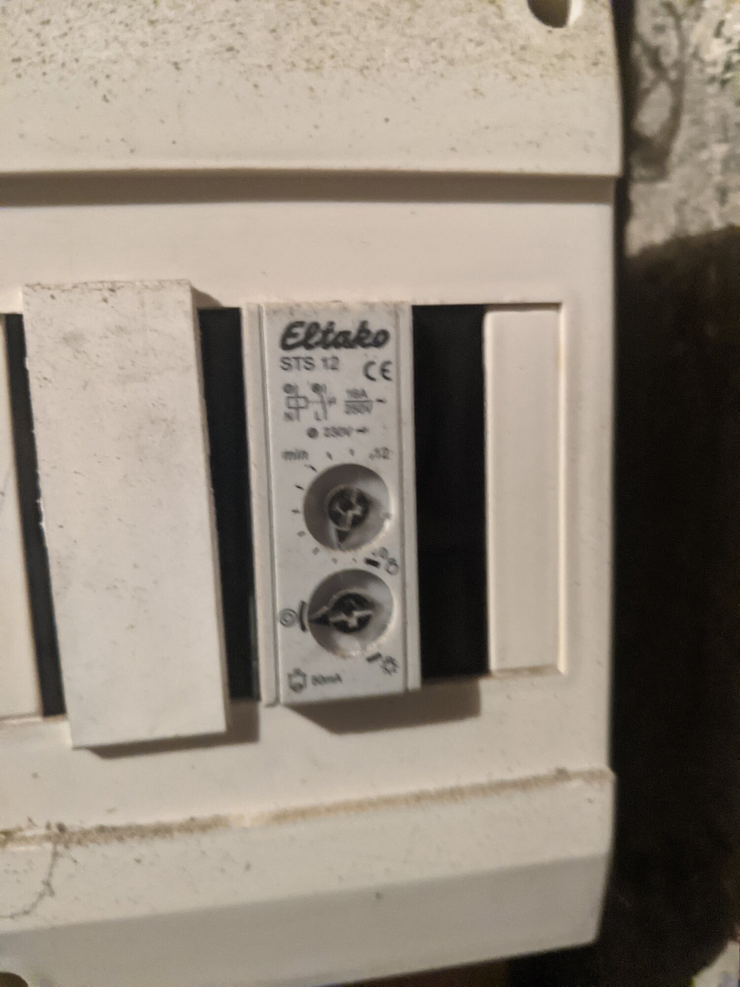

I was looking for some advice on common wiring styles for stairwell delay lighting circuits. So I can figure out what has been done in the existing wiring since I have committed to try and add some PIRs to an existing stairwell delay circuit in the block of flats that we are living in.
The current situation:
multiple rail mounted 'eltako sts12' stairwell timers (cant find manual online but very similar to attached photo of a current model)
multiple standard 1 gang wall mounted momentary switches
What I have managed to find to install:
2 x 1 Gang wall mounted PIRs 2 wire switched live (i.e. no neutral needed, live IN, switched live OUT) - so latching switch equivalent (pic attached)
My plan:
To replace a couple of the strategically placed momentary switches at the entrances to the building so that it automatically turns on as you enter, and you can also use the momentary switches on other parts of the building. I was thinking about using some sort of monostable non latching relay to simulate a momentray swtich (but with a 5 second press rather than the usual quick press, becuase 5 seconds is the shortest PIR setting I have) this will work becuase the timers are simple and dont have a anti-block feature.

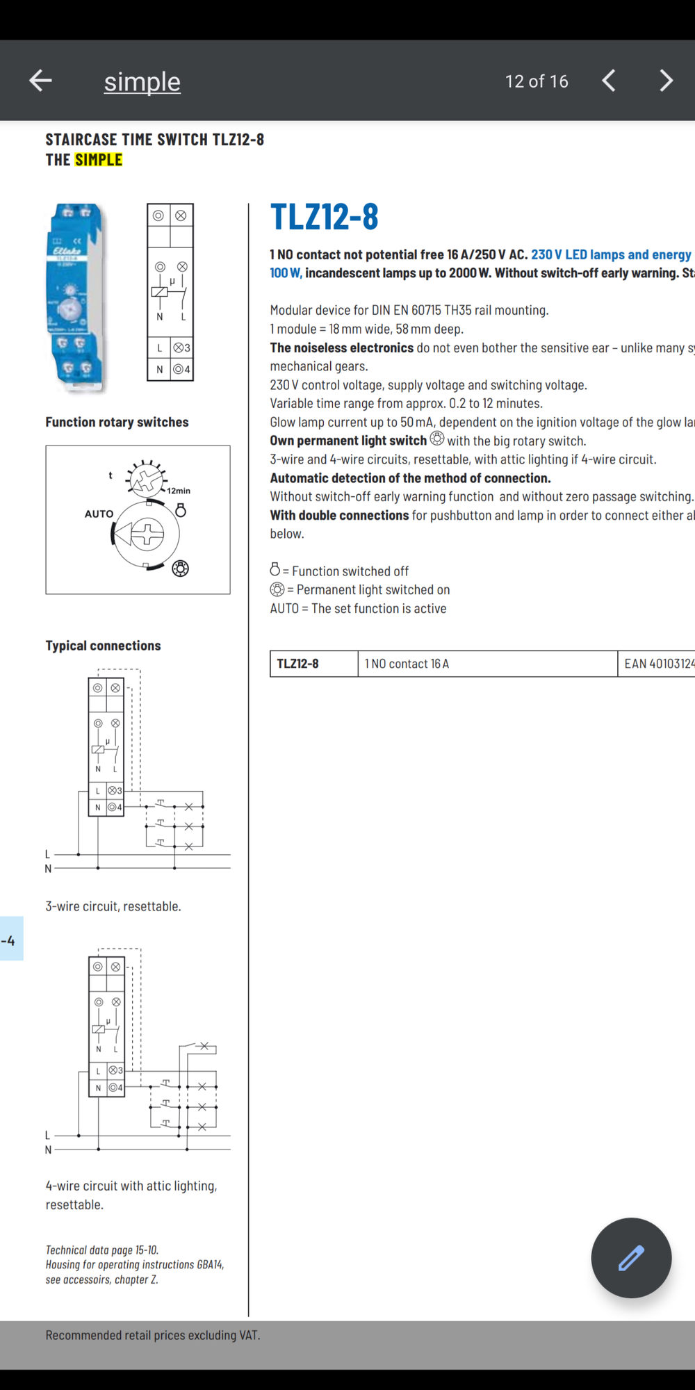

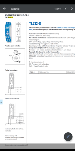

QUESTION 1 - It doesnt make sense to me the wiring in the wall boxes of the momentary switches that I dont see a live on neutral engerised wire in the wall boxes based on either the 3wire or 4 wire connection diagrams (pics attached) that the original electrician you would expect would have followed. Does anybody know why this is? Is there another "standard" way of doing such setups that isnt as per instructions from manufacturers?
QUESTION 2 - Has anybody inserted such as stairwell setup with both momentary switches and PIRs, and if so, how have you done it?

What have you got wiring wise at the existing switches?
It sounds like it should just be a straight swap - the existing momentary switch is just closing a contact and as long as the pir doesn’t need a neutral then that would do the same thing and trigger the timer. It shouldn’t matter if the shortest trigger time is 5 secs, that would just be like pushing the switch for that long.
I think I might be inclined to swap one switch for a pir - providing you take the necessary precautions of course. The worst that should happen is it won’t work properly and you can put it back to how it was.
in some of our blocks of flats the push button momentary switches send a quick switched live to the staircase time , all the lights are connected to that and stay on for the required time, you may be better off with a microwave light fitting to switch the lights.
