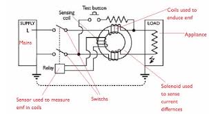

Hi guys,
I have brain freeze and need some help!
I'm currently looking to run in a radial socket outlet circuit to a bedroom from a spare way in the consumer unit. The total circuit length will be approx 10 meters of 2.5 t&e. The supply is a TNC-S arrangement with a Ze of 0.13ohm (by direct measurement). The circuit protection is by way of a 20amp Type B BSEN60898 mini circuit breaker. NO RCD!!
Normally I would just follow the typical values in the OSG. This time though, I decided to just calculate it... Have to keep doing it once in a while or I'll forget!! :-/
The cable itself is fine (obviously) until I check the cpc size using the adiabatic equation. Can someone tell me if I've got this right? :-/
Ze = 0.13
R1+ R2 = 0.23 (adjusted for temperature @ 10 x 19.51 x 1.2)
Zs = Ze + R1 + R2
= 0.36
230/0.36
= 639A
K factor = 115
Assuming instantaneous time of 0.1sec
S = sroot(639*x0.1)/K
= 1.76??
Thanks in advance! :-)
i see where 639A has come from...
but you are looking for the fault current needed to acheave a .1 to 5 sec disconnection time...aren`t you...it aint 639A...is it
looks like youre gonna need a cable with at least a 1.75mm cpc , which will be 6mm t&e ;-)
or maybe look at time current graphs for a 20a mcb ............
which will probably end up giving you a min cpc size of around half that.

Hi Paul as your figure calculated using the adiabatic equation will not get a corresponding figure of t from the time / current graph you can obtain the I2t energy let through figure from your MCB manufacturer, you can then substitute it into the adiabatic equation.
The I2t figure for a crabtree starbreaker 20A type B 6K mcb is 22260 put that figure into the adiabatic .
Square root of 22260 / 115 will give minimum size cpc of 1.3mm.

Thanks for reminding me of this; they list I²t figures in the technical section at the end of their catalogue. As it happens, I generally use Crabtree Starbreaker, but does anyone know whether these figures are typical for other makes of BS 60898 circuit breakers?
