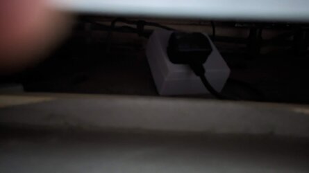

-trailing socket on floor is not ideal but very common and if cable is clamped corrected in trailing socket, doesn't pose any danger. Electrical work is not designed around possible plumbing leaks in your house

I'm not sure what you mean by clamped I've attached a photo below of the fridge socket if you can advise that would be great.

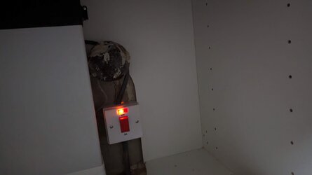

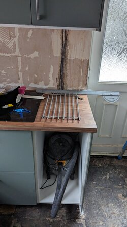

To clarify the connection between the hob and switch isn't the issue that's surface mounted (although there is a junction box that looks to be loose now that I check. The issue is that the feed isn't in a valid location that I can see. I've included some images showing the rough positioning. The cupboard containing the isolation switch is the one below the hob, not the one below the cable.

Tell me that cooker switch lash up in the 3rd photo isn't the finished install

An example of the long term race to the bottom of quality of work in our industry, IMHO.
