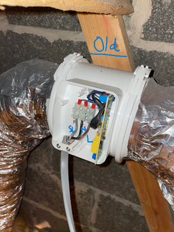

I've recently replaced my 4 inch centrifugal extractor fan fitting in the loft. I was hoping for some advice on if this is wired up corrrectly. The fan itself is working well.
Old fan had timer, new fan doesn't have timer.
Both fans are turned of via the pull switch in the bathroom.
I wired it up to match the old wiring:
  • First image attached is the old fan showing its wiring,

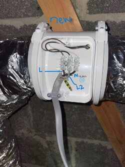

  • Second image is the new fan showing the new wiring,

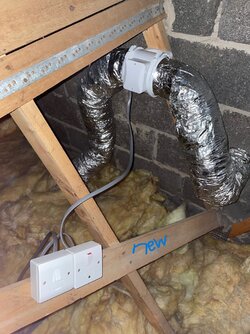

  • Third image shows the existing switches next to the new fan (left off, right on).
With the old fan, this worked with both switches turned on. With the new fan, when both switches are on, the fan runs constantly. If I turn the left switch off and keep right on, the fans works as expected (on and off using the pull switch in bathroom).
Wanted to check if I'm good to leave this set up how it currently is regarding those left and right switches. It doesn't have any issues in how it functions. I just wasn't sure what that left switch has to do with this new fan / how I've wired this new fan up and why it causes the fan to run when switched on.

At a guess, the original installer (whose workmanship suggests was not a professional electrician) tried to comply with the manufacturer's instructions that the fan should be fed via a 3A fuse, and the only way he could think of doing this was to fit one in both the permanent live and the switched live.

Still not convinced this is the correct fan. There's no sign of an adjuster for the overrun timer.

Hi thanks for your reply. The new fan doesn't have an overrun timer. I purposely went for one without it. Thanks.
In that case you have connected it incorrectly. The permanent live should just be terminated to a loose connector block and not connected to the fan.

Thanks. Is this a fire hazard in it's current set up?
This is probably a two speed fan, and without seeing the installation instructions, I can't say how it should be wired, but as things are, with the switches on, you are applying power to a stalled motor, which possibly isn't a good idea.
Disconnect the permanent live, as I said.
The other thing that stands out as wrong with the wiring is that, not only has the neutral wire not been identified with blue sleeving as required by the regs, but the black wire has been used as the neutral instead of the grey, which is contrary to convention.
