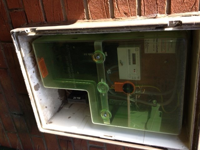

Hi, All I got great advice on here re solar pv (which is working very very well) a couple of years back and I am looking at some enhancements and things seem to have moved on in the metering dept and I was looking at the Chorus PV solar monitoring system.
In particular how it works by measuring the electricity imported and generated using the flashing led on the meters. Now if I was to get one installing the generated sensor would be easy but the import sensor is going to be challenging maybe. My import meter is in an externally housed electric cupboard as fitted to new houses 20 years ago. Everything inside the cupboard except the big fuse is in a big green plastic bubble/shell whatever you call it and it is impossible to get near the meter.
Am I out of luck or could an electrician gain access to the inside of the green plastic bubble thing? or can only the electricity company do that?

This is what I mean. It must come off and it looks like two bolts hold it on. Also looks like there was an orange plastic tag of some sort but that has been broken, probably by the electric company guy who changed it to a digital meter about 2 years ago.
[ElectriciansForums.net] Advice on Chorus PV Meter - Import sensor fitting
So question is who is allowed to remove this?
How odd, of all the properties we have installed (5000+), I've never seen such a device. If the tag/seal is already broken, I'd say invade it.
All of them around here have them. Never seen it on any others anywhere else either of my friends but I am not an electrician so don't generally go poking into electric meter cupboards :)
Hence why I wanted to know if it's something only the electric board were allowed to open or if an electrician could do it.
I'm not saying interfere with the electrics but placing a Velcro pad on the pulsing light of the meter shouldn't raise any eyebrows. If you feel strongly about not removing the cover, play it safe and add another clamp to the tails. I've installed a wattson monitor with a monitor already on the tails and it hasn't caused any problems.
OP - the Elios4You will provide all your monitoring requirements, without any tampering of the utility meter, will be 1-2% accurate and can also proportionally control any excess generation of PV energy being diverted to the immersion using the Power Reducer control bolt-on. Runs on a free iOS or Android app, provides a whole host of data and has a number of other features/functions.
I'm bias, of course, but you might want to just check it out as a possible option
