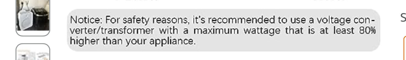

Hello , thank you so much for your reply. A lady is selling one over here - please see link - Amazon.com - https://www.amazon.com/MYOYAY-Transformer-Transformers-Electrical-Protection/dp/B08FMJ2TH7?th=1&psc=1
You think this would be ok?
That's an electronic unit, not an actual transformer. In my opinion it is under rated. The diagram of good to bad indicates a 2400W load is in the middle "might be ok/might not be ok" area of the chart
Their recommendation below works out that you should use a transformer rated at 4446W (80% higher than your appliance)
Which it isn't!
If the seller of the item has used it for the same purpose as you propose to, and for a reasonable length of time, then maybe it would be OK, otherwise I would avoid it!
Which it isn't!
Thanks alot - all noted. I’m not going to bother now , the air fryer will be running for a good amount of time , she was using it for her blender from the uk which I’m assuming was a quick 2 min job. Thanks again for your time!
