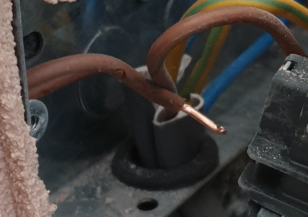

Hoping I could get some independent advice on here. We've just bought our first property and had to get a full house rewire on the property (3 bed semi). Our electricians had finished the work within 2 days (2 electricians working on it). When asked when they were coming back, they said they didn't need to come back for a second fix as they'd finished it all. As we didn't know any better, we assumed all was fine and paid up because that said they wouldn't give paperwork till payment was made.
Since then, we have had a few issues. Our plasterer has been really surprised at the poor standard of work - they have had to plaster around all sockets and spotlights in kitchen.
1. The holes made to put in the sockets are generally quite a bit larger than the face of the external socket casing.
2. One of the sockets had a loose wire that was not connected when the plasterer was plastering around.
3. Another socket melted the builder's plug (smoke coming out as well), but didn't activate the trip switch.
4. An armoured cable they put in to light the garage is coming out of the consumer unit and through the floorboards in the bedroom in front of (rather than behind) the skirting board.
5. No paperwork 3 weeks after despite chasing him for this before everything else happened.

As others have said not tidy but not as bad as it could be and in the sparks defence the loose wire could’ve been caused by anyone moving that socket front.....did you agree to him second fixing before the spreads had been in?

the holes might not be the tidiest but in fairness some walls when you chase them out crumble and lumps come out. the chasing doesn't look that bad to be fair from what I can see on the cable runs.
what was specified or agreed with how the armoured cable will be installed as from what i see the reason its in front the skirting board is because it comes out directly above from the consumer unit. even if behind it will still need to come out the wall a few inches below the bottom.
That wire that has come out could well be live !!

The second fix has been done. That is the connection of all the accessories, testing, and energising.
This should not have been done ahead of the plastering but that is down to what arrangements were in place between you and all trades.
You should have received an EIC and building control paperwork.... keep pestering them for this, all in written form, and if they ignore you it's time to get in touch with trading standards and/or the scheme that your electrician belongs to.

Hi, looking at those pics, putting back boxes in solid walls, you nearly always end up with larger holes than the boxes, due to the nature of brick/block work and plaster breaking off.
As others have said, fixing the face plates back, should be done after the plastering and painting has been completed.
As for the live coming out, with all due respect, if this had been fixed I’m securely (I always give my conductors a good tug to ensure they’re secure) it shouldn’t have happened, even if the plasterer has pulled the socket, as this could happen to anyone taking off the face plate in this instance.
A loose conductor should have been detected during testing, with a higher resistance reading. It would be interesting to see the schedule of test results for this circuit
I will weigh in here with my opinion.In general,from the photos,it doesn't look a bad job at all.There are grommets in the boxes,sleeved earth wires etc.The main issue is that they have put the socket fronts on before the plasterer has done his bit.Also the swa in front of the skirting could have been done better but generally a cupboard would be built around the consumer unit and wiring which would cover the swa,so really it's not too big a problem.
The wire coming out of the socket is due to the plasterer pulling it too far forward and yeah it should have been tighter.
The blown single socket looks like it's been caused by what ever was plugged into it,not the socket or the wiring.But with out taking off the single socket to check behind,its only speculation.
So in general the install isn't as bad as everyone is making out ie calling them cowboys etc.Trust me I have seen alot worse.
The only real crime these electrician's have committed is second fixing too early in my opinion.
