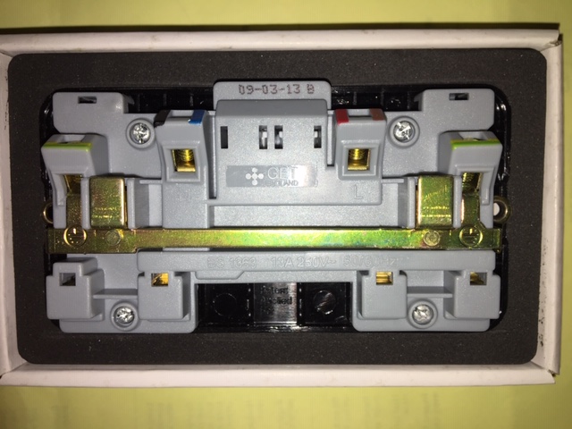

Hoping I could get some independent advice on here. We've just bought our first property and had to get a full house rewire on the property (3 bed semi). Our electricians had finished the work within 2 days (2 electricians working on it). When asked when they were coming back, they said they didn't need to come back for a second fix as they'd finished it all. As we didn't know any better, we assumed all was fine and paid up because that said they wouldn't give paperwork till payment was made.
Since then, we have had a few issues. Our plasterer has been really surprised at the poor standard of work - they have had to plaster around all sockets and spotlights in kitchen.
1. The holes made to put in the sockets are generally quite a bit larger than the face of the external socket casing.
2. One of the sockets had a loose wire that was not connected when the plasterer was plastering around.
3. Another socket melted the builder's plug (smoke coming out as well), but didn't activate the trip switch.
4. An armoured cable they put in to light the garage is coming out of the consumer unit and through the floorboards in the bedroom in front of (rather than behind) the skirting board.
5. No paperwork 3 weeks after despite chasing him for this before everything else happened.
Would really appreciate any feedback as not sure if these are common or we really are within our rights to be taking this further? We tried contacting the electrician a couple of days ago, but he's not able to come till Monday evening, but his general response is telling me that he's blaming the plasterer's work.

From the pic, it wouldn't have taken much for the cable to come out, as it looks like it's only had connection at the tip of the wire.

The melted socket is likely to be caused by what has been plugged into it (plasters 110v transformer would be my guess)
The loose wire is a bit more worrying and is probably down to rushing. Proper testing should have detected that issue.
The SWA going in front of skirting.....who knows why, perhaps there was something obstructing the route behind the skirting or being in a rush it was quicker to put it in front

The line conductor that pulled free probably won't have shown up in tests. The screw seems to have indented the copper (albeit in the wrong place) so there would have been a solid metal-metal connection when the testing was done. It was mechanically weak because it wasn't inserted far enough into the terminal.
The problem with this issue is that while it is probably a one-off, it could also point to a bad termination technique on the part of one of the installers, who might simply not be in the habit of tug-testing etc and might have done the same in other fittings.
The burnt socket could be anything, possibly the plug that was inserted. If the front of the socket is more burnt than the terminals at the back, it wasn't the electricians' fault. If the terminals are badly burnt, I would suspect another inadequately inserted cable and would then be keen to have all accessories checked. OP- you wouldn't necessarily expect anything to trip due to bad contact that causes overheating. The MCB would trip in the event of a short-circuit, and the RCD in the event of a leakage e.g. shock to a person. Means to detect this kind of fault (AFDDs) are just being tentatively introduced. They have to be pretty sophisticated to tell the difference between a heater heating up and a plug heating up!

I wouldn't agree there. To be honest inspection would be far, far more likely to pick that up than testing. If there was fortuitous contact between the conductors during testing there is no likelihood of finding that through test readings. It's possible to pick up poor contact resistance but it really depends how the two conductors are seated. If the contact is good between them (though not securely screwed together) I don't think passing 200mA through them will tell you much.
