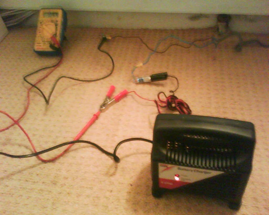

TOOLS NEEDS:
MULTIMETER, SCREWDRIVERS & BLOCK CONNECTORS
This is quite simple see following pictures (Much easier to do then first impression on reading instructions), the MultiMeter in this instance (DRAWN, POSITIVE TERMINAL) tests the AMPAGE between the POSITIVE SUPPLY (red probe lead) and the POSITIVE LOAD (black probe lead). Hence the NEGATIVE is uninterrupted from SUPPLY to LOAD (In other words, leave it alone). In this instance the positive supply has croc clips, normally I'd use insulated BLOCK CONNECTORS:
PIC1 (multimeter measuring AMPAGE between POSITIVE supply & POSITIVE load)

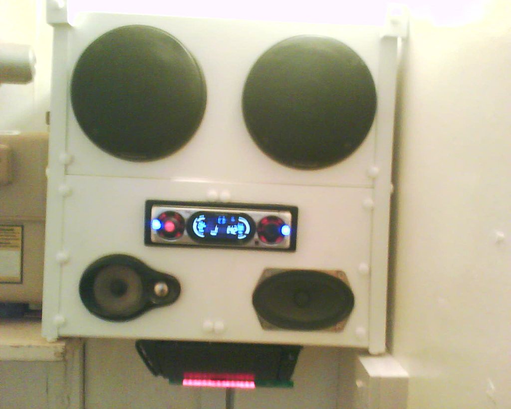

PIC2 (12V dc Battery Charger powering car cd player, with MultiMeter Testing AMPAGE)
PIC3 (CAR CD PLAYER in house install powered by CAR BATTERY CHARGER 12 V dc 4A)

TOOLS NEEDS: MULTIMETER, SCREWDRIVERS & BLOCK CONNECTORS
This is quite simple see following pictures, the MultiMeter in this instance (DRAWN, POSITIVE TERMINAL) tests the AMPAGE between the POSITIVE SUPPLY (red probe lead) and the POSITIVE LOAD (black probe lead), this is known as breaking the circuit. Hence the NEGATIVE is uninterrupted from SUPPLY to LOAD (In other words, leave it alone). In this instance the positive supply has croc clips, normally I'd use insulated BLOCK CONNECTORS:
PRECAUTIONARY NOTEs:
~ Obviously the NEGATIVE and POSITIVE can NOT touch each other (Neither SUPPLY or LOAD)
~ If your MultiMeter has NEGATIVE READING, your PROBE LEADS are the wrong way (Or ignore negative symbol, as AMPAGE figure is accurate).
~ The 12V dc MOTOR/PART or ALTERNATOR/SOLAR PANEL may CHARGE/DRAW a greater AMPAGE/CURRENT then the capacity of MULTIMETER & its LEADS (At this point the actual ampage is unknown). Eg: Most car electrical parts are low current (Indicators, elec windows, elec sunroof, heater, etc), with the obvious exception of a car starter motor (Extremely high ampage/current, totally unsuitable for testing with MultiMeter). Hence if 12V dc part/motor or charge rate of power supply is greater then 10A this may melt your MultiMeter probe leads and/or break the MultiMeter (Unless you have a 20A DC MultiMeter! Obviously the ampage max of those is 20A DC).
OTHER NOTES:
~ The AMPAGE reading of your MULTIMETER, is given by testing 'A' POSITIVE or 'A' NEGATIVE, however the AMPAGE reading is total AMPAGE drawn/charged, so this figure should NOT be doubled in your calculations.
~ My preferred practice/method, & the MOST accurate, is to connect new leads to the battery terminals, so there won't be any other registered ampage drawn from the car battery. So the ampage reading is what it is! (PS. Don't mess about from behind the car fusebox, keep it simple, either direct from car battery and loom OR new power leads from car battery to motor/part/device/appliance your testing with a MULTIMETER.)
~ Alternatively (The least preferred, & least accurate) If you're testing direct from a car battery and it's loom, it may have other parts/motors draining ampage, such as indicators/wipers, etc. So turn ON the ignition (WITHOUT STARTING THE CAR, as the ampage drain would be far too great for the MULTIMETER & PROBE LEADS!), then make a note of what the standard ampage drain is approximately (i), then turn on the motor/device/appliance you want to test (ii). Then subtract the standard ampage drain from the new figure with the appliance/device/motor on to EQUAL the difference (iii) i.e. The ampage of the motor/part etc.
FOR EXAMPLE:
i) STANDARD AMPAGE DRAIN = 0.5a (Car alarm or something else)
ii) STANDARD AMPAGE DRAIN & OTHER MOTOR = 1.5a
iii) CALC 1.5a - 0.5a = 1.0a
