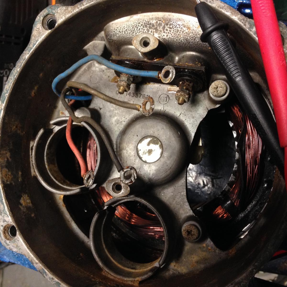

If I open up the motor (been in there already for a once over and to free it off) can I swap the orientation of the central outer section (don't know the correct term) whilst leaving the armature and end caps in the same relative positions. I'm guessing there will be a couple of wires to swap as well although as the photo shows - the 2 supply cables are connected to the centre 'barrel' NOT the bottom end cap.

The motor is Flp (flameproof) and in the terminal box there is no access to the start winding.

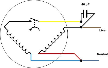

To reverse this motor the start windings need to be swapped. the start winding is usually thinner and is connected to a simple centrifugal switch. The motor will have to be stripped down to access the windings.
[ElectriciansForums.net] Ancient single phase electric motor  - reversing the rotation
In the above drawing i have not connected the start windings to anything just tried to explain where they need to go

If it is a split phase motor there's two ways to reverse the direction, either you can reverse the two wires of the start winding or you can reverse the run winding. Actually there's three ways, you can also occasionally unbolt the two end caps of the motor and reverse the entire stator but this is not advisable unless you know the motor was specifically designed to do this.
To reverse the start winding you'll probably have to remove the entire termination block with the connection posts on it and look underneath it. You should see the four winding wire connections under there. To identify the start winding you'll need to resistance test both windings and the start will be the one with higher resistance.
