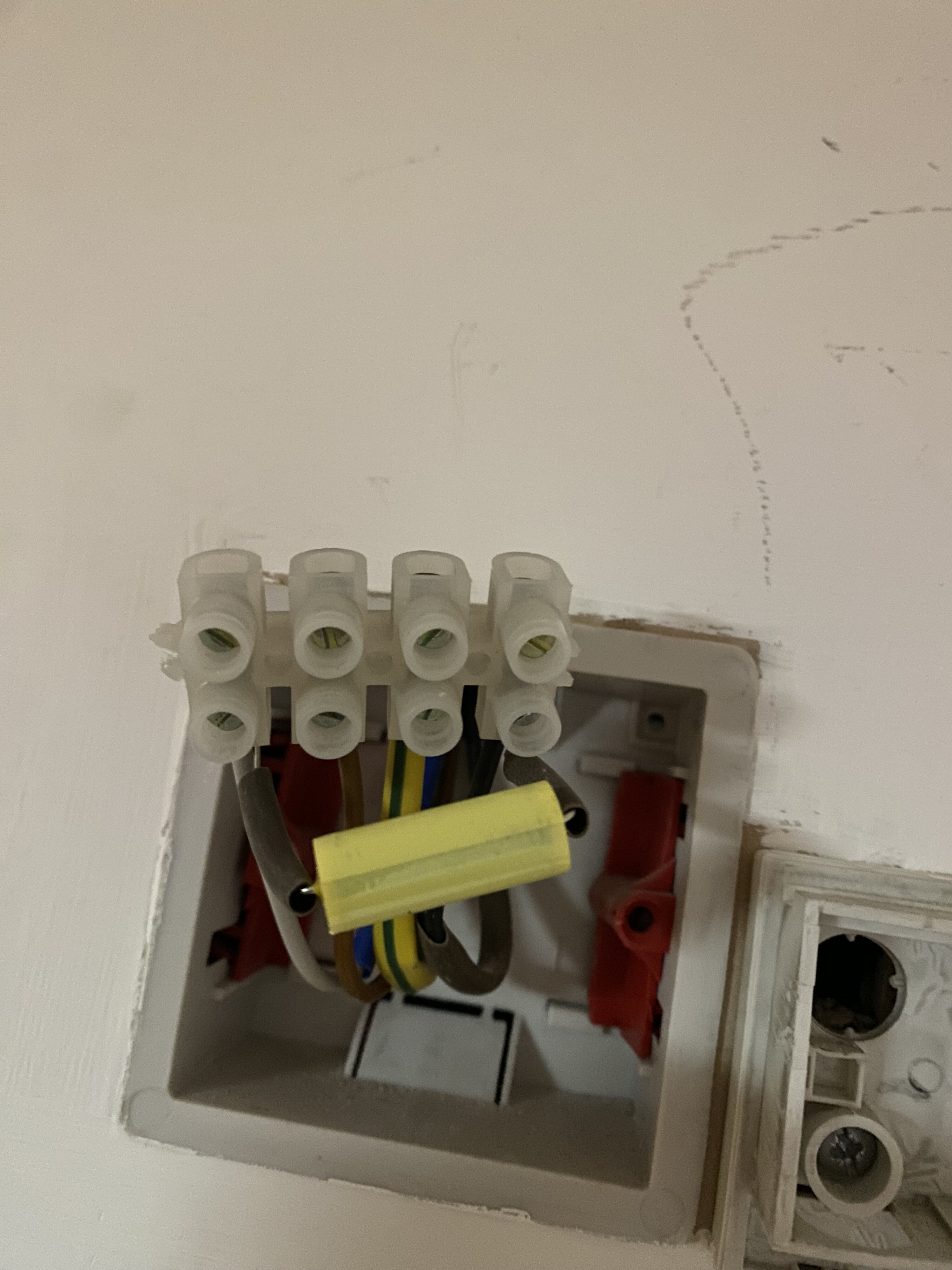

I'm currently working in a building that was completed in 2006. All the lighting is switched by wall mounted PIR and these capacitors seem to be installed at every PIR connection behind a blank plate. The capacitor is connected between the switched line and N Just wondering if these were needed for the old lights as every light is LED now?

There was probably a relay, inductive load involved, so used a capacitor for induction suppression.
Caps were also required when the lights were a small load to operate correctly with some 2 wire PIRs and timer switches that have no neutral connection. The timers current draw would be enough to make some fluorescent lights flicker etc.
Looks to me like it's being used as a snubber to prevent the LEDs from glowing even when the switch is off, due to the effect of capacitance in the cables.
The op said it’s leds now so I assume it wasn’t before
