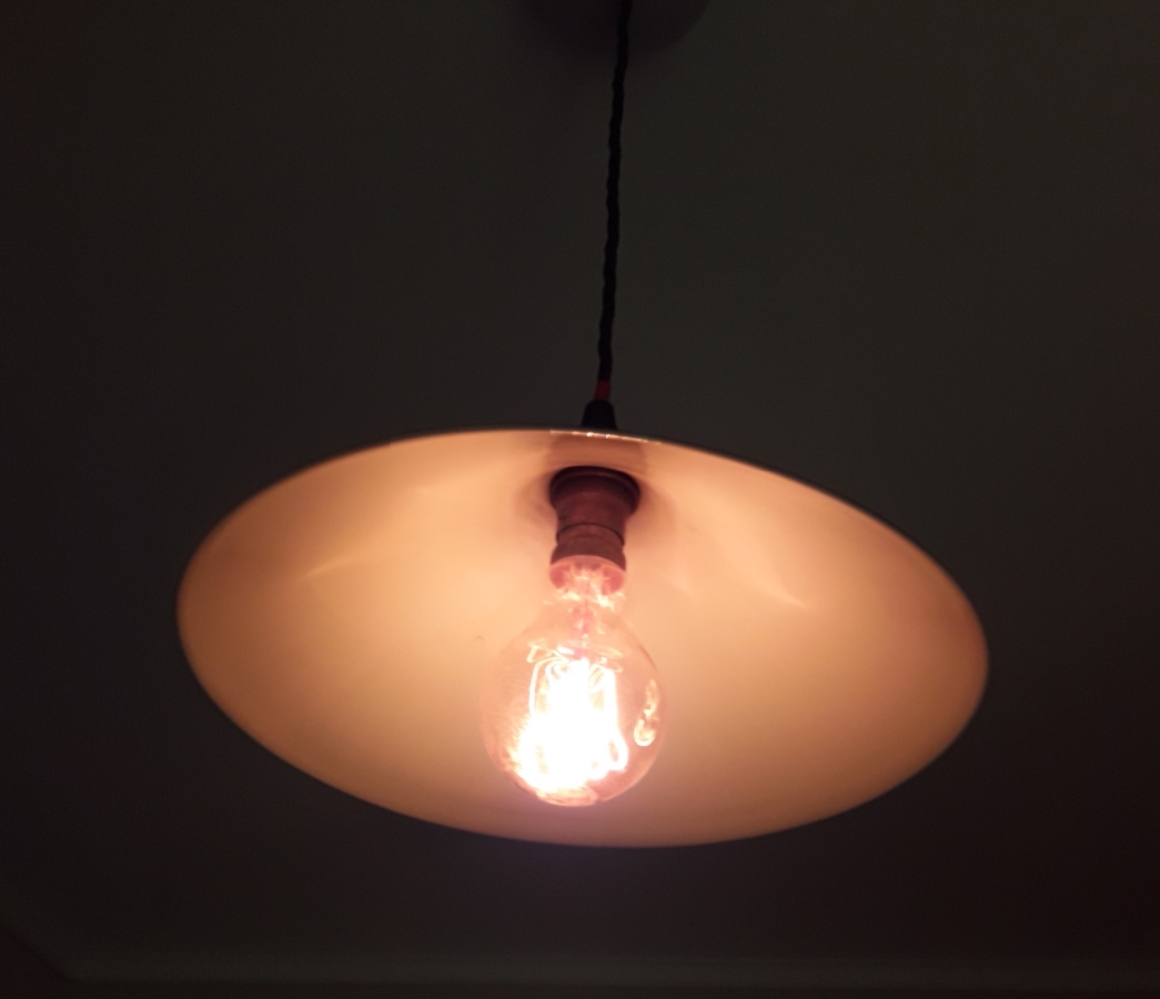

This one was probably made sometime around the 1920s, I wonder how many LED lamps will still be working at 100 years old.

Tungsten was definitely a step backwards in terms of reliability.
Halogen more so.
CFL was a stopgap solution.
I have every expectation some of my LED lights will last well over 20 years.
Also my three bed semi with every light on including the floods in the garden uses under 300W. I'm willing to accept the occasional replacement.
