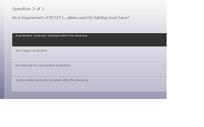

Hi, As a requirement of BS7671, cables used for lighting must have a protctive conductor included within the sheaving.
Could tell me where I can find this regulation in BS7671?
I am sorry for such a basic question.
But I appreciate if somebody can help me.
Best regards,
There is no such requirement. BS7671 requires that all accessory points have a cpc run to them but does not prescribe the method by which this must be achieved. You could use twin with no cpc and run a seperate cpc. It'd need to be 4mm though!!! So, if you think about it, from an engineering point of view a cpc in twin sized to be large enough for any device the cable could be connected to is by far the best and most cost effective solution to the requirement.
BS7671 does quote BS6004 though - don't know the ins and outs of that standard, but I'd bet it requires a cpc. I've tried buying single with no cpc but no-one seems to do it, only single plus cpc.

[ElectriciansForums.net] As a requirement of BS7671Hi PC Electrics. Thank you very much for the quick reply. As you can see this is the question. I answered it correctly but I just wanted to find out it from the BS7671 to get used to it before my exam.
I,ve seen black double insulated singles with no cpc our local council wire all their house lighting in singles,red has cpc and black doesnt can,t remember who makes them though.
