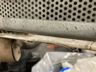

Hi I’ve just been to change a heating element and come across this it was all crumbling away does anyone know if this is asbestos?

Yea I did the work then worried like a idiot thanks tho cheers
It's worth getting yourself on an asbestos awareness training course, the basic one are usually just 1/2 a day and if you shop around you might get a deal. I did the full course, where they train you to work with non licensed asbestos. There are a few kinds some are worse than others so its good to be aware of this also.

Nice one, There is also a list online of storage heaters that contain asbestos. http://www.storageheaters.com/asbestos-list.htm and another...
