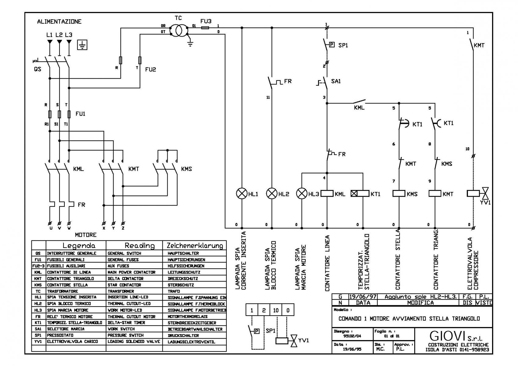

So I`ve bought myself a big three phase compressor with Auto Star/Delta Starter. But there is a missing part in the Auto Star/Delta Starter box. I get in touch with the manufacturer of the air compressor (ABAC) and they sent me a wiring diagram of that "auto star/delta starter box (pretty basic) and what they said was I am missing the transformer. Long story short the guy said it will either be 240v or 24v and I can check this by checking the coil voltage of the contactors and source the transformer from a good electrical retailer. But what contactors and how to check I don`t have any idea.

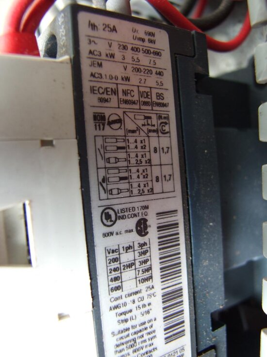

The Coil is at the back of the contactor and will have either 240v or 24v written on it or a tag with it on.
Above. Just get someone competent in to do this for you. If you're really desperate get a 24v DC PSU and try it, if it doesn't pull the contactor in then obviously it's 240v. If you don't understand a thing I'm saying, definitely get someone else.

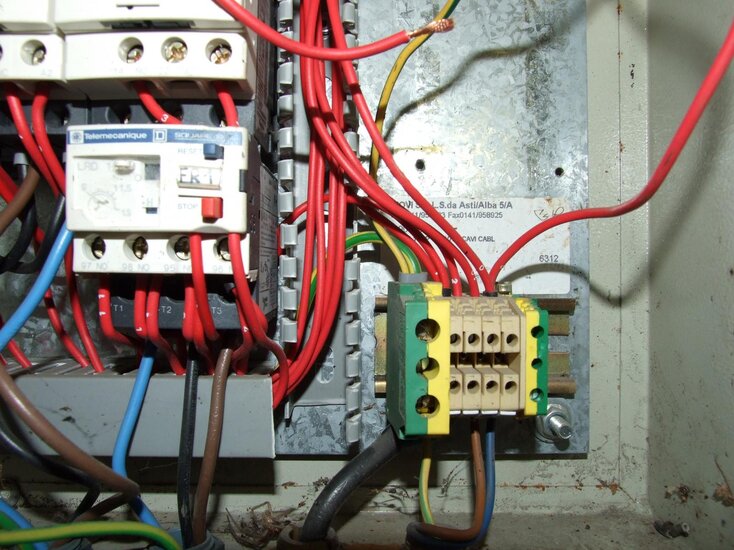

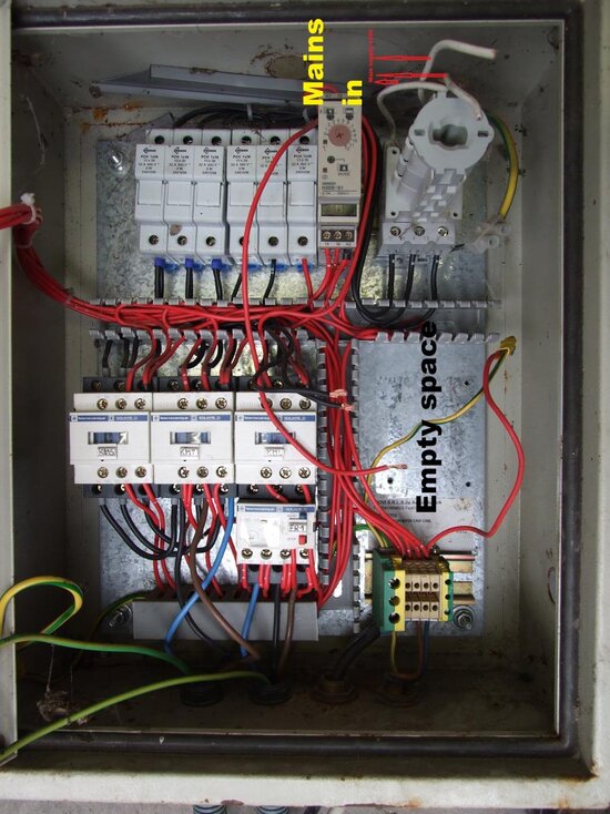

So here are the pics. The wiring diagram of the box and a pic of the boxes internals and the missing part (empty space)

'The guy' is lying to you, the transformer should be 400V primary and the secondary will need to be whatever the voltage of the contactor coils. If you dismount a contactor from its rail you should see the coil voltage marked somewhere on it.
I'd suggest you source the transformer and get someone competent to install it and test/check the wiring before you connect the supply. It's going to be a costly, not to mention possible dangerous exercise if there's a problem.
You mean the one that is marked as "KML" and in the diagram they call it main power contactor. Is that right.

The transformer isn't powering the Motor, it's powering the contactor coils, a solenoid, pressure switch and a few indication lamps bla bla bla. Find out how much amperage the components after the transformer draw. Convert your amps to VA and choose your tranny accordingly.
Simple. Add some garlic to the spaghetti all will be fine. You don't give anywhere near enough information. I could have a guess, as many on here will but I don't like making mistakes. coil voltage, supply voltage and coil loading are needed to give a reasonable answer.
