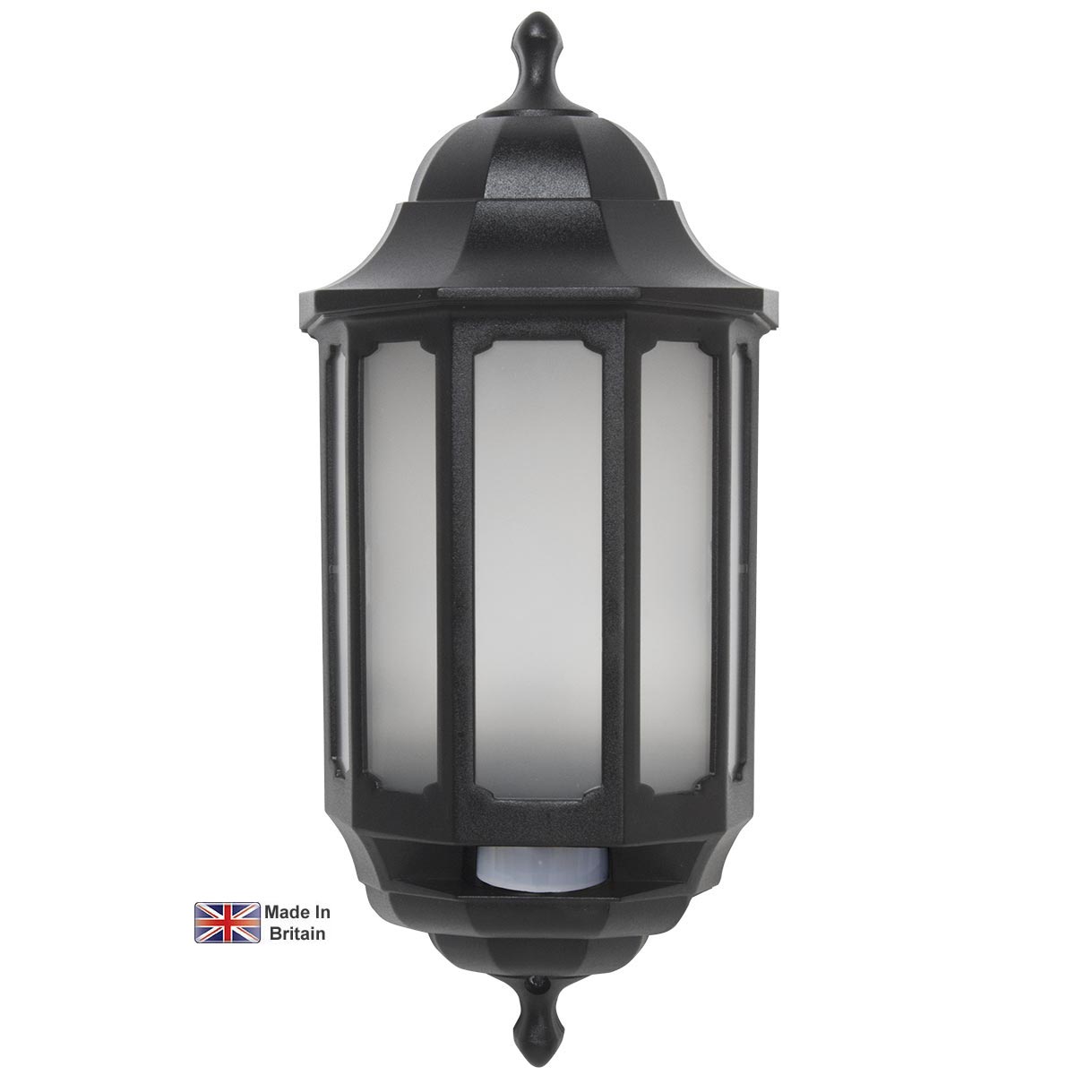

I have searched online, have a few ideas, but I'm getting old...
Basically, I have a bin store which has light on the ceiling...you can use the switch to put the light on, but only when the entrance lights are on...they are on a Sangamo timer.
I can easily lead a permanent feed to the bin store, so I intend to fit a simple LED batten in there, which comes on when anyone enters.
What I would like is a recommendation for an LED batten light which incorporates a sensor, PIR or Microwave, so that when a resident goes to deposit rubbish, the light comes on for, say, one minute, while they dump the rubbish, then goes off til the next time.
I know...lots of ways to do this...but if possible, I'd like to do it with a lamp with integral PIR or microwave sensor, rather than wiring a lamp plus an external sensor
Please let me know how you would fit this...so many options, so I just want a simple one!
Thanks!
I'll start with this, I may update the selection later;
Problem is apart from Dawn to dusk is people will "Borrow " it and forget to bring it back..
2 problems I can see with this one, out of stock and not cheap and possibly the "Borrow" issue
In stock but still has the other issues.
Possibly a winner🥳
Cef sell tamlite/xcite vapourproof fittings with integrated microwave sensor. Don't often promote cef materials but I was supplied them for a job and thought they were impressive.

Do you know anywhere that does a dual light level dusk till dawn lamp
Do you mean a hi-lo?
Maybe like this:
The client already has the light fitting just need a dual level lamp with a dusk till dawn and security sensor....Thanks for reply
