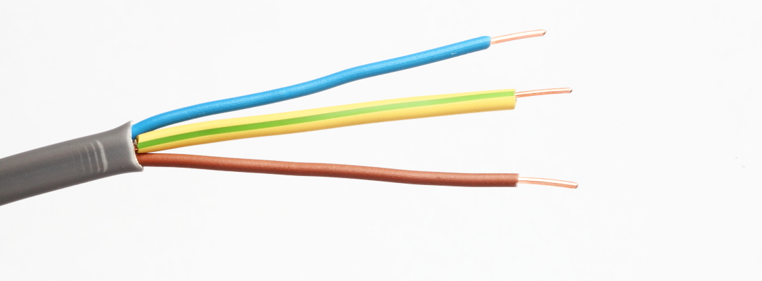

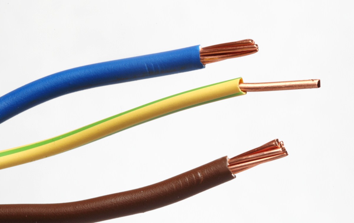

I have the CK stripper, maybe I haven't adjusted the thing right.
It leaves marks on the cables, See my snaps below. It doesn't seem to expose the copper.
But it made me feel uneasy enough to get out of the habit of using this thing and go with side cutters.
1.5 mm2 T&E
[ElectriciansForums.net] Automatic Wire Strippers - your opinions and thoughts please
4mm2 T&E
