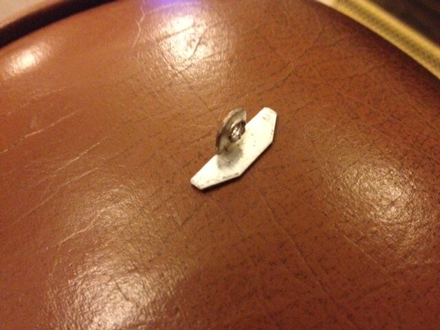

Hi, I've got a back box buried in the wall and one of the little screw hole sliding thingies (see photo) is damaged (hole's burred). Does anyone recognise the brand so I can buy a replacement back box and transplant this bit of metal!?

Most likely Appleby by the looks of it, but most LUGS can be made to fit.

Drill a 3mm hole in the back of the box directly behind the defective lug, thread that out to 3.5mm with your rethreading tool, then your front plate screw can go into that. I did this for the first time a few weeks ago on a box where the bits of metal that held the movable lug broke off, and felt smug that it worked. :)
nah, dis. that useless gn/y sleeved cable, remove sleeving, put 1 through each screw hole and bend over.
