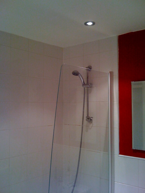

Hi All,
I'm at the start of my 2330, so please forgive the question.
I've got 4 x 12V 50W downlights in my bathroom ceiling at home, they are all fire rated, but are IP20.
I know that lighting with IPX4 has to be used in Zones 1 and 2, but the downlighter is 1.3m off the floor level, so outside of the zones.
So as reg 701.414.4.5 (ii) says that a SELF/PELV circuit has to be IP XXB or IP2X am I right in thinking that this is okay?
The closest source of water to the light is a shower head thats not fixed, that comes off a mixer tap. I know it would be best to change all the downlighters to atleast IP44 and firerated but that is quite costly if you dont want one where the lamp sits about an inch away so gives a very narrow beam.
Photo is attached for clarification!
Thanks in advance!
Gafin.
  • [ElectriciansForums.net] Bathroom Downlighters and Zones
Gafin, its not clear from your pic whether the light is over the shower screen or inside of it,or outside of it.....if any of the first two then it is a possibilty that it could receive inadvertant spray from the unfixed shower head. In these instances it would require protection from external influences....i.e. to IP X5
Guys, we are just confusing Gafin. I have quoted the regulation which we can all read. As long as the transformers are fixed in the loft so we cant pull them through the hole whilst having a shower, then it is fine as is.
Its a selv circuit.
From my understanding of his initial question, he was asking "are his IP20 lights" safe and if not what should he replace them with.
I gave him the simple answer with the regulation. If he was changing them for his own piece of mind, then I would follow what he says and would do the same in my home.
With his ceiling at 2.3M he could put a 240V fan above the shower (providing its RCD protected and ip x4) so which is the greater evil, the 12V light in or the 240V fan.
Sometimes, to many answers just confuse the initial question.
no beef of course we're all obviously being as pro as poss :eek:
If its a selv circuit and the transformers in the loft as well as the fittings being above 2.25M from Finnished floor level there out of zone no problems. I assume the swith is outside bathroom door.
Very good diagram on BRG p169 showing zones.
also Reg. 701.512.3
I agree with dave
Besides i have them:cool:
