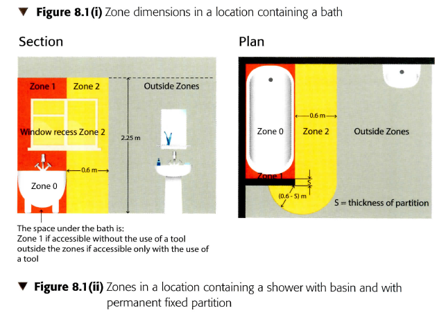

Just as a bit of additional info. Bathrooms have Zones and depending on where the extractor fan is fitted depends on the IP Rating the extractor fan needs to have.
Where about, relative to the bath, is the extractor fan being fitted? Please give dimensions.
Also the wiring for the fan will have to have RCD protection. Does you consumer unit have an RCD?
This work may fall under Part P.
[automerge]1567592050[/automerge]
Just to make it simpler for you mate. Below is a screen shot of the different zones.
What zone is your extractor fan going in?
