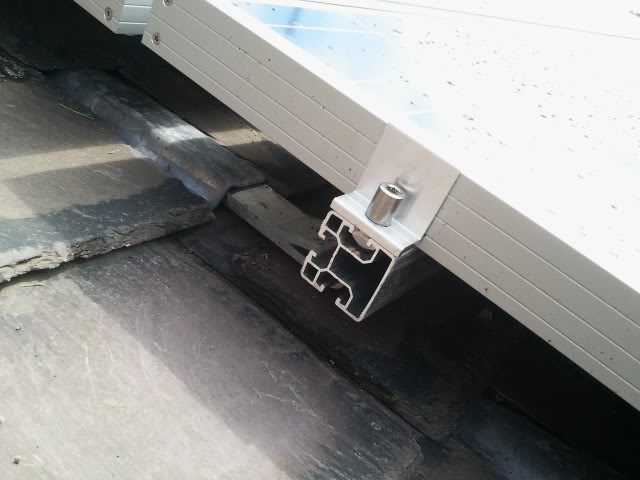

A picture of the flashed in method as previously discussed:
Thanks for this pic I am about to fit my first system and was begining to question in my mindwhat I Learned.. Pictres speak 1000 words:bow:

Energetic, obviously 'fixing through the slate' needs to be done - in a literal sense - in every case. But, what I understand the posters above are saying is that, it shouldn't be done with the slate in situ, such as by drilling a hole through it into the rafter. For one thing, it'll be hard to weather-seal that hole afterwards in a reliable, long-term way. And also drilling a large screw fixing into a narrow 'modern' rafter doesn't leave too much material either side...
The 'flashing' method - as I understand it - essentially involves removing the slate where the fixing is to be, screwing/bolting a clamp to the rafter below and then refitting the slate cutting it as necessary around the clamp and using lead flashing to seal it and make it permanently watertight.
I'm not convinced this is any better than hanger bolts, the bracket rests on the slates underneath, which are drilled through, which then take the weight of the array. At least with a hanger bolt the weight is trasferred to the rafter or truss.
Don't get me wrong there's issues with hanger bolts but there's issues with any slate fixing method i've found yet, and in many cases issues with slate roofs without PV systems. As i've said previously on other threads i've been on slate roofs with broken or even missing slates that don't seem to leak, or even get noticed by the householder.
We choose a fixing method on the individual roof, no method is 'best' or perfect for slate as there are different types, qualities and conditions of slate, you just have to go with what you think is going to do the best job for a given roof...
I can't say I understand the different methods as I'm a lay-man not an installer. However, I am fairly familiar with roof construction.
Again, my understanding is that when using the 'brackets' (ie: the method shown in the photo above), by removing and then cutting the slate around the fitted bracket, the slates themselves are not 'underneath' any bracket and are therefore not under any weight or additional stress.
The top slate is cut around the bracket, the overlap of the slates means there will be at least another one or two slates underneath the top one at any given point.
