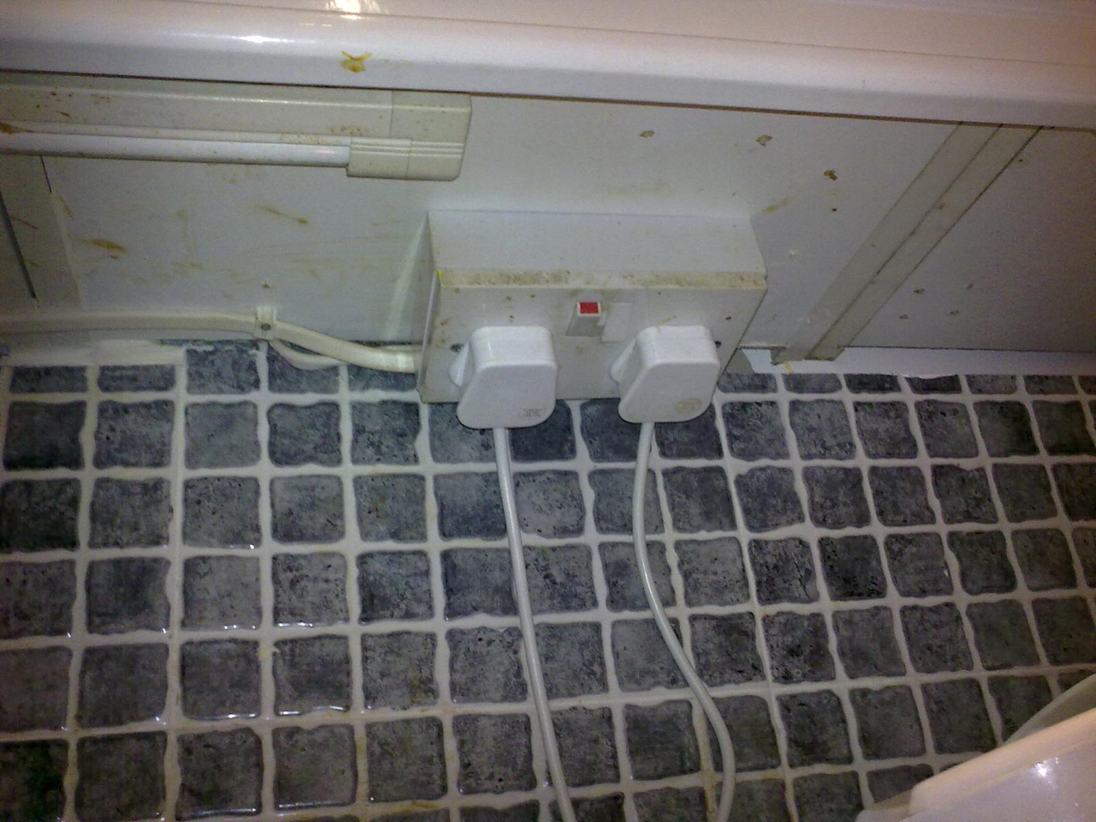

Hi,
Sockets are daisy-chained from the only double socket in the kitchen and stuck under cupboards as shown in the picture. Can't chase the walls and ruin the tiles. In this situation, how do I add more double sockets along the worktop, taking the existing ones down? Don't want to use surface mounted boxes.
Any advice is much appreciated.

can you cable through the wall units and sink sockets just below? if they're not on the ring, you'll have to fit a FCU as well.

you could take the wall units down,normally on brackets anyway,chase the wall to where you need to go and refit the wall units.
It has been known for people to sink the metal box at the required level,one side of the hole "happened" to go straight into the cavity
Once this unfortunate accident happened,there was an hole drilled into the cavity at the existing socket and a cable fished to the new position, with the result that a flush socket was fitted with no damage to the tiles and in a usable position,lucky or what

most kitchen units have a gap behind them for running cables and pipes (drilling maybe required) just disconnect the old sockets an run new cables along the back of the cupboards upto the worktop but make sure you leave a gap above the work top for wiping down so you donty get water in the sockets.... or call a electrician...

That's one of the options but the project will go over the budjet. I am trying to sort out the electrics for a chap who recently moved into a property and the surveyor picked up a few non-compliances; there are quite a few addons done by the previous owner (probably a DIY'er) and the wiring is a real mess.

Angled trunking is one way around your problem. comes in 3m lengths you can mount the sockets anywhere along the entire length. Used them myself in similar situation to yours.
Marshall Tufnell is the one i used, but there are others...

The above, was a friends kitchen that had only one double outlet, it now has as many as he wants to install. He, and his wife are more than pleased with the result!! Also fitted same stuff to a work bench in his workshop.
