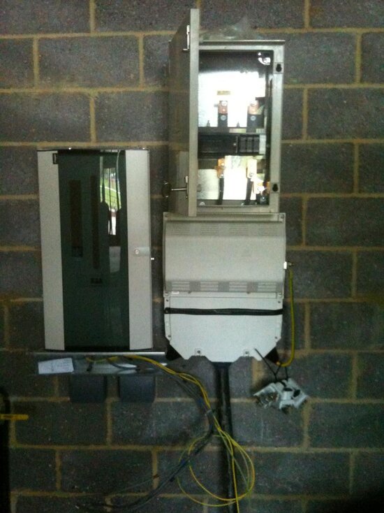

Recently won a contract to fit out mew nighclub / bar, the client had already contacted DNO regarding supply etc and had elected British Gas as supplier.
Client informed me that they had requested 100a TPN supply and that the service head was to be installed Wednesday 21st April and that they needed the D.B. in place before they could install meters
Installed D.B., 2no RCBO protected sockets for builder Tails MET etc, called in on Friday to check all was O.K. the client was going ballistic, they turned up install the head but could only terminate cable as there was no electricity available for their tools ( I kid you not ) anway got them back and they installed the head they then asked the client when I was installing CT chamber I explained I wasnt and in anycase 100a supplies are usually monitored via whole curent meters , three day's later CT hamber was installed( just chucked on the wall ) and on Friday I had a panic phone call from the client asking me to attend site so they could do a load test after installing the meters ( no nor have I ) anyway I turned up and the meter installer asked me for the C.T s - well to start with I asked why the CT chamber Dunno mate I was just told to fit it So how am I to get trunking to the top of that then Dunno mate not my problem Well you'll have to move the head and the CT chamber . No mate you.ll have to move the DB
Well I can't move to the left because of the gas service and your heads on the right what do you suggest Cant you move into the room next door No mate ladies cloakroom Oh well you'll have to phone the office - I did and there going to move it , but I had to explain to them that metering should supply the CT's ( they are now looking into it ) So be warned if your dealing with british gas, B Global ( metering) or ES Pipelines your in for a bumpy ride
And yes the DB is Plumb.

Our local DNO usually fit a ryefield unit complete with all the CT metering installed. The customer then decides on who they're gonna buy their leccy from and they come and fit the meter to the outside of the unit, job done. Sounds like you had a right game there....
Local DNO passed the job to ESP ( ES Pipelines ) who acted as DNO - B Globe installed the meters - so all work subbed out to non communicardo contractors
ESP turned up on Friday , Op came in and asked to speak to me ( as luck would have I was there)
He asked me if I knew how to fit the CT's ( I kid you not ) so went through the fitting, wiring to test block fuses etc , he then asked if I 'd do it for him which I agreed to do on an instruction from his boss which he did text over however , wrong CT rating and one wouldnt fit onto the CT chamber busbar ( L3 resticted by Neutral bar ) so the saga goes on this is the third week since they first appearde on site!
