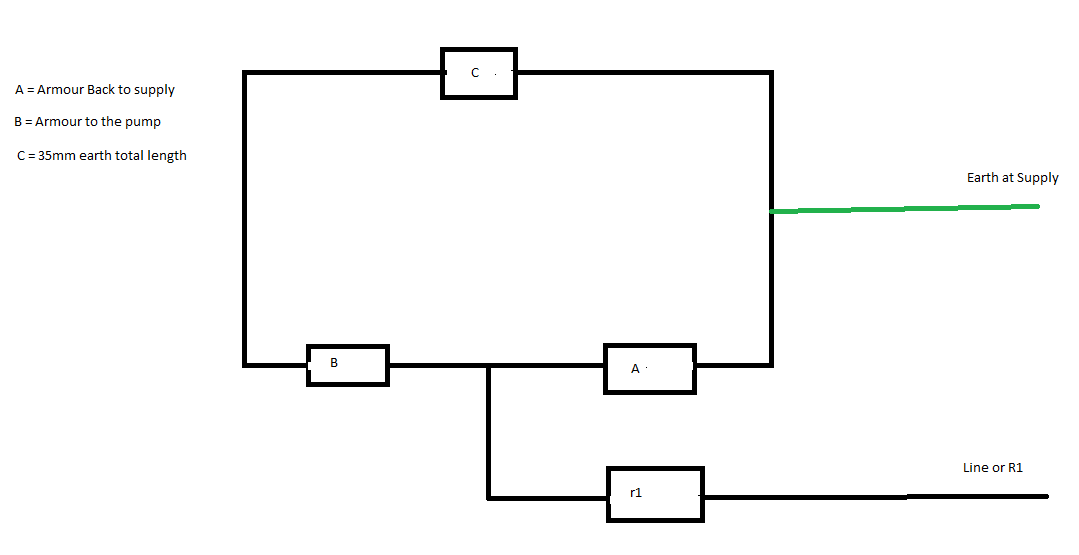

Just putting the design together for this, and am using BS88 bolted fuses. The Current Characteristics scale at this level (compared to a 6A lighting circuit) is pretty scary... It will supply 200A for 1000S before rupturing! Pretty worrying when you think you could use a 70Degree 25mm cable on this. But i suppose as long as Iz is greater than In then all is good. But still... :-)
For fuses typically your disconnection times are met for about 5*In which is scary if you spend too much time thinking about it. But the time/current curves of fuses/MCCB/MCB are all based on the typical overload survival of cables. You just don't want to do it too often!

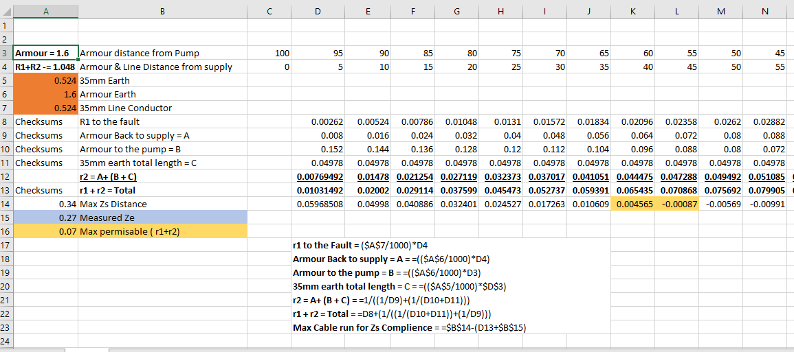

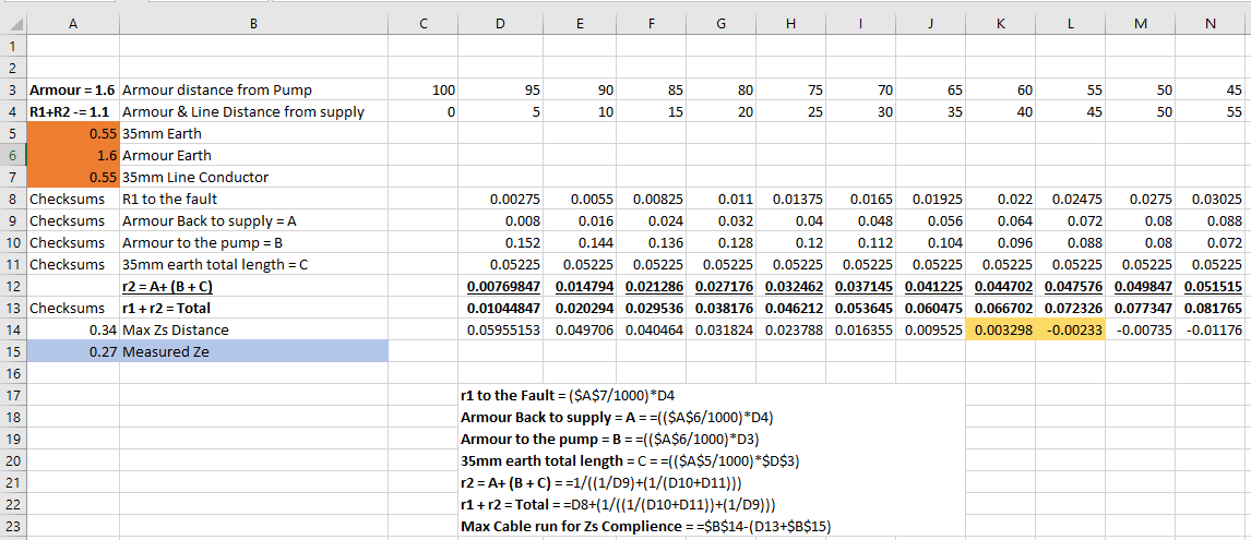

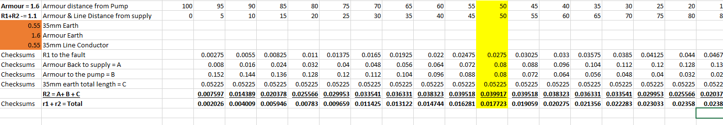

Okay, it has been a while since i have had to do these calcs, so am a bit rusty - please be gentle if there are glaring errors, i am trying to do the right thing. I also think that i am being over conservative re the size of the cable. It is only buried for 10% of the length (where it enters and exists buildings) and moves from being a 25mm to a 35mm as a result of ref method D...
I still need to measure Ze, and i think i missed to adjust R1+R2 from tabulated to temp compensated.
Also as i am used to using certain cable types, i never really appreciated how much that the higher Temp (90deg) cables offer (v.s. 70Deg) such a significant increase in CSA - stands to reason i guess. Just need to specify the correct BS when I order the cable...
Attached are the details of the electrical part of the project i have put together, and the calcs i have performed based on the info i have obtained. I have Used the BBB :-) but i don't do these types of designs every day.
Incidentally i will be installing RCDs on the outputs of the speed controller to the pumps, as the Pumps are outside on metal and wooden frames sat on gravel and concreate. They will be interlocked with the fault monition so if an RCD trips, the controller will also be shut down. Resetting an RCD on full load could result in some pretty fireworks...
I would be grateful for any comments please.
Thank you.
John

100A fuse in Table B3 of the OSG has 0.34 ohms as measured (i.e. cold) Zs for meeting 5s and also adiabatic for 16mm CPC so no issues there.
If the supply is TN-C-S and reasonable, say better than 10% drop on full load, then your supply Ze is going to be around 0.23 ohms (23V = 10% at 100A, probably less, but to be measured or inquired) so max R1+R2 for sub-main limit is 0.34 - 0.23 = 0.11 ohms.
Assuming 35mm 5-core cable then R1+R2 as seen from volt drop tables as 1.25 mOhm/m so length limit is 0.11 / 1.25E-3 = 88m and as longer than your 50m planned length is met.
If you are really paranoid about worst-case cable fault you would look at armour resistance and work out the worst place for a fault, etc. Looking at the Prysmian data sheet for 35mm 5-core the armour is 1.6 mOhm/m so the worst location works out at 34.9m from the supply end and R1 there is 0.022 ohm and R2 is 0.028 ohms (armour from source in parallel with remaining armour to end and the 5th CPC core back to source) so R1+R2 worst-case fault location is 0.05 ohms and less than the above limit of 0.11 ohm based on a guestimated Ze and fuse for 5s sub-main.
Alternatively you could say max Ze = 0.34 (max fuse) - 0.05 (worst case R1+R2) = 0.29 ohm.

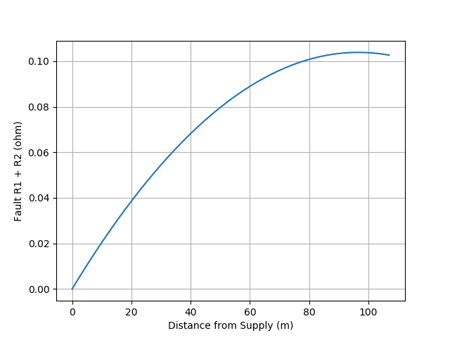

Realised I made a mistake in the worst-case armour location as I solved for the highest R2 location, not the highest R1 + R2 location. Actually result for same assumed values (0.625 conductors from VD tables, 1.6 armour, 50m total) is 0.054 at 48.2 meters, so not much far from 0.05:
If there are dual pumps for redundancy reasons you really don't want a fault on one taking out the main supply fuses :(
Based on what I calculated some 50A switched-fuses might be better as combined isolators and final circuit protection, and then a small CU or DIN board for the distribution of power, extra circuit's RCBOs, and any SPD needed.

Stuffing in the PDF values for 35mm 5-core and 63m I get:
Enter line R1 in mOhm/m 0.524
Enter CPC R2 in mOhm/m 0.524
Enter armour R2 in mOhm/m 1.6
Enter length in meters 63
Maximum fault R1+R2 = 0.059 at 55.6 meters

r1 will always increase as you move away from the supply.
A will also increase as you move away from the supply
B will decrease as you move away from the supply
C will be a constant but is in series with B.
Both B+C are in parallel with A.
Therefore
r1+r2 = r1+ 1/((1/A)+(1/(B+C)))

But yea, around 50m i make it

I think i got to the same / similar answer:
Therefore
Basically that is how I calculate it, but using some python script so I get a pretty graph out of it, etc. Putting in your numbers I get:
Enter line R1 in mOhm/m 0.55
Enter CPC R2 in mOhm/m 0.55
Enter length in meters 107
Maximum fault R1+R2 = 0.104 at 96.7 meters

More worryingly for me right now is that our answers do not match, inclined to think that it is my maths not yours :).
I would love to have a look at your code, but right now i need to get my head around what i am doing wrong here...
I found some bracketing errors and sorted those but still not matching. Then i realised that i may not have solved the parallel resistance values correctly for A, B and C?
I am now wondering my assumption that B and C are a simple series circuit in parallel with A is the issue:
This is the formula i used
r1 + (1/((1/(B + C)) + (1/A))) = r1+r2
r1 is in series with A, B and C so no special care needed for r1.
A has a parallel path back with B and C. And B and C are in series, but collectively in parallel with A.

This is the spreadsheet with the formulas revealed-: -

I didn't know if it was more complex, along the lines with this example - but it seem you agree with me and therefore it is not: -
If my math is correct i am scuppered anyway, because at just after 40m 5 core 35mm i exceed max ZS just after 40m away form the supply: -

Checking the numbers I used before getting 0.104 ohm at 96.7m of 107m we have:
R1 = 0.55 * 96.7 / 1000 = 0.053185
A = 1.6 * 96.7 / 1000 = 0.15472
B = 1.6 * (107 - 96.7) / 1000 = 0.01648
C = 0.55 * 107 / 1000 = 0.05885
B+C = 0.07533
R2 = A||(B+C) = 0.050663
R1+R2 = 0.103848 which is 0.104 ohm to 3 digits.
Try it with some of the numbers I just did to see if they agree at all, I can post my script later as text if anyone wants to play with it. In the mean time I re-ran a manual calculation for the solution my script found and it seems to make sense.
OK, got my script and edited to add end-of-cable result, ran with your values:
Enter line R1 in mOhm/m .55
Enter CPC R2 in mOhm/m .55
Enter length in meters 100
Maximum fault R1+R2 = 0.097 at 90.4 meters
End fault R1+R2 = 0.096 at 100.0 meters
