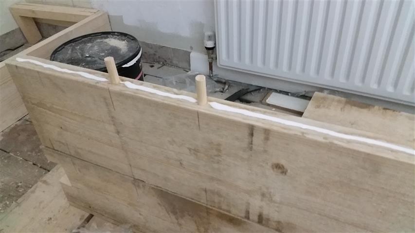

Me and the gf have just got our first gaff together and basically can't afford out! So i am building whatever i can. I have designed the bed but started first with the wardrobe.
I am making it out of scaffolding boards mainly due to how cheap i can buy them, heres a couple of pics so far....

But no i haven't, never done much work with wood but seeing as i have done everything else in the house i thought i would give it a crack. I have just bought the collins wood bible (should be £25, £2.50 on amazon oosh!) that has various joins etc.
I am having varying success with the dowel to be honest although it looks good once done its taken a bit of fannying about.
What would be the advantage of biscuits? I am building the doors out of multiple pieces to get the affect that i want so maybe i should consider biscuits??
I'm thinking once you've routered out your slots for them, you'll get a more accurate joint, i.e. less sanding down afterwards.
Drilling holes by hand can be a bit random! :-)
Woahh wooah, theres nothing random about it. Accurately measured with a steel ruler and marked up with a metal try square! But you have a point :)
I don't have a router unfortunately! One issue i am having is that all of the boards are marginally different widths, so i have been doing some inventive planing and sanding. 80g,120g then raising the grain and cutting back with 240g twice. Then waxing twice!

hi I did 15 yrs building furniture from old pine ,etc old floorboards are good with the tongue an groove removed ,buy yourself a biscuit jointer ,some old caustic for colouring and fiddes wax.scaffold planks are ok for table tops ,but remember to use buttons to keep the top floating (stops it cracking ) pm me if you need any help

the rails which the table top sits on have a groove in them ,about 6mm wide and 6 mm deep about 12mm from the top of the rail all the way round (do that first ).then you make buttons from scrap wood maybe pieces of 20mm thick by about 50mm wide and 75mm long these have a rebate at the end which sits into the groove and is then fastened to the table top with a 45mm screw thro middle so the top is not actually fastened to the side rails but floats on the buttons.also good is pvu glue (foamy) sets in half hour and works on damp timber .also van dyke crystals to stain it .get hold of a fiddes catalogue (wales) there is evert=ything you need to finish wood

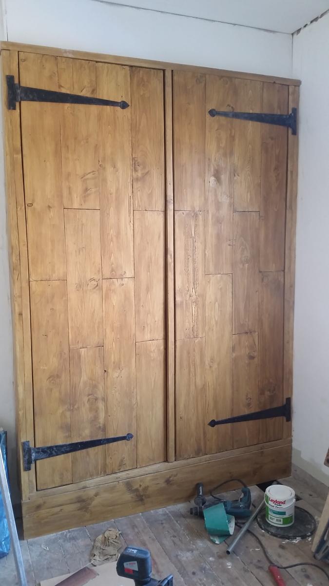

Thanks for the replies, i need to start hunting for hinges next. I have already sourced the scaff poles for the hanging rails :)
not sure if the coat hanger hooks will fit over scaffold pole. why not use 20mm galv. conduit?

I checked the coat hangers would fit :)
Thanks mate. Strangely enough it was actually cheaper for me to custom build them than it was to buy the chipboard equivalent from Ikea.

Well i have almost finished it and i have almost finished the bed too. I forgot i had started this thread so apologies for not updating it (if anyone was bothered!)
