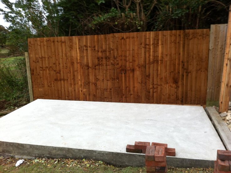

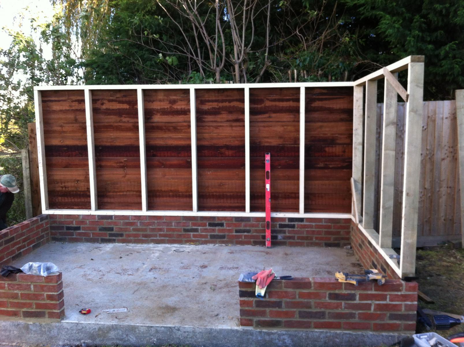

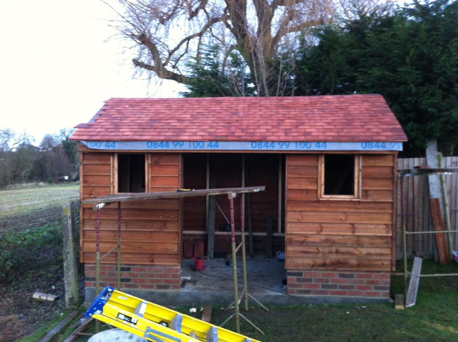

Having built a few sheds in my time I would suggest a concrete base (pre-mix is always best) followed by a few courses of bricks to lift the wood from the ground so as you get no rotting. I had a load of tiles left over from a build and most of the bricks were recycled also. I constructed a framed roof and tiled it with some tyvek underneath. The doorway is wide as it is now fitted with sliding doors. It got broken into so if i did it again now I would fit a deadbolt lock and doors opening from the centre. I recycled the frame and roof from some 8 x 2 treated lengths of wood my father in law bought from a farm sale. The brickwork took me about three days , it would have taken a bricky about 4 hours!:) And yes the sides now have noggins and diagonal braces!
