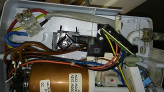

hi im redoing the bathroom and the 9.5kw shower is on this cable which has burnt at the connector block at some point its on a B32 MCB
im not sure what size this cable is, measuring the cable width it looks to be 6mm2 measuring the conductor looks to be a 10mm2
the diameter of the individual conductors is between 4-5mm
the width of the overall cable is about 14mm
the earth is significantly smaller, slightly thicker than a 2.5mm2 conductor
pictured next to 2.5mm2 cable for comparison
when i put everything through the IEC calculator it says the earth size should be the same as live and neutral cable wrong anyway?

I just find it strange that a plastic connector is screwed down like that…. And I know that’s the way everyone does it.
Metal screw possibly cutting into the plastic, reducing the insulating material and creating a weakened path between the live copper and the cpc through the screw.
Not the problem here, I should add.
This is simply a loose connection causing heat
I’m 99% sure it is looking at that, as above comparing the 2.5mm cpc with the 2.5mm T+E it looks spot on.
(If you have a micrometer you can just halve the measurement of a single strand, multiple by itself then PI, then by the number of strands (usually 7) to double check.)
