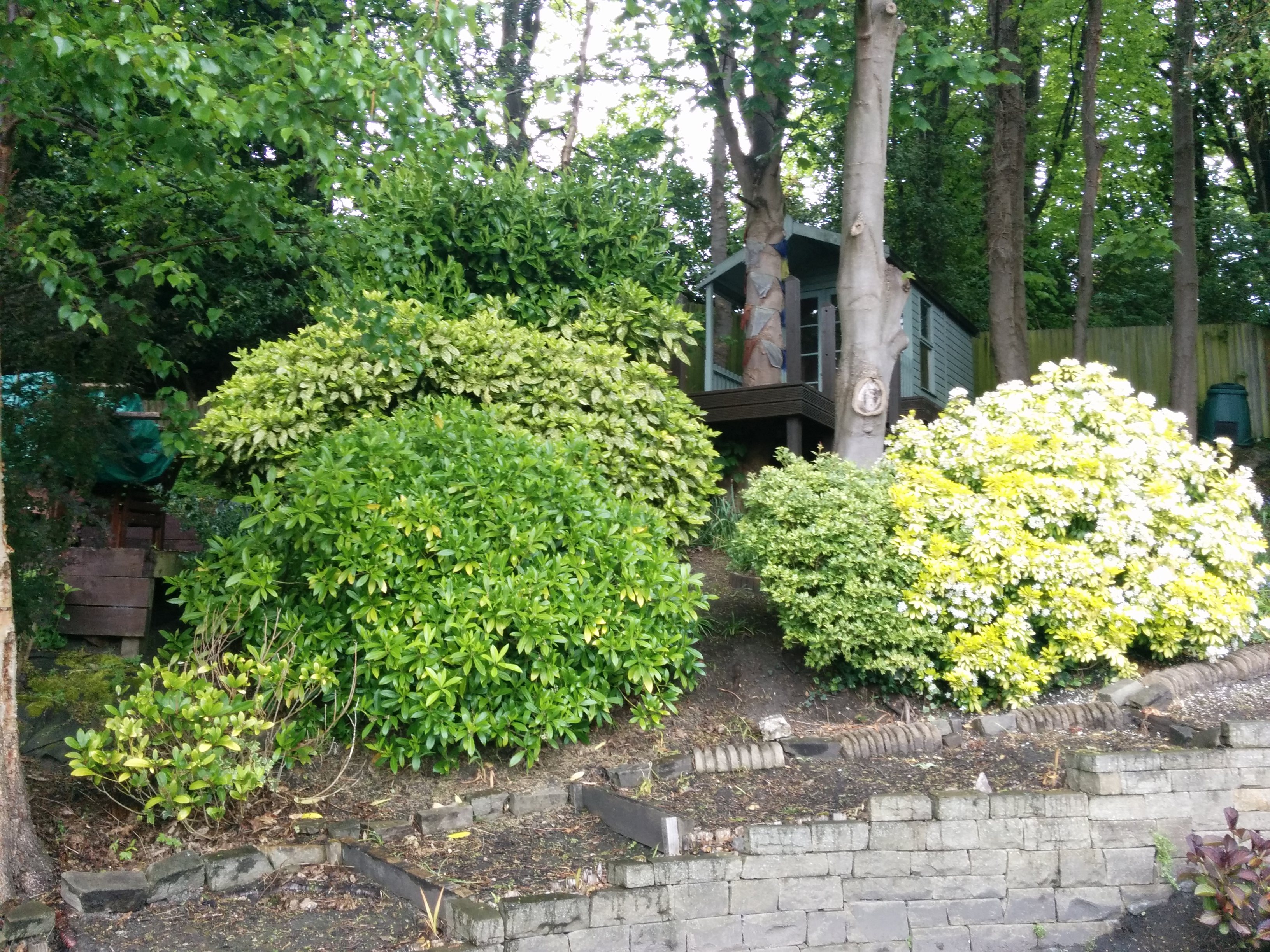

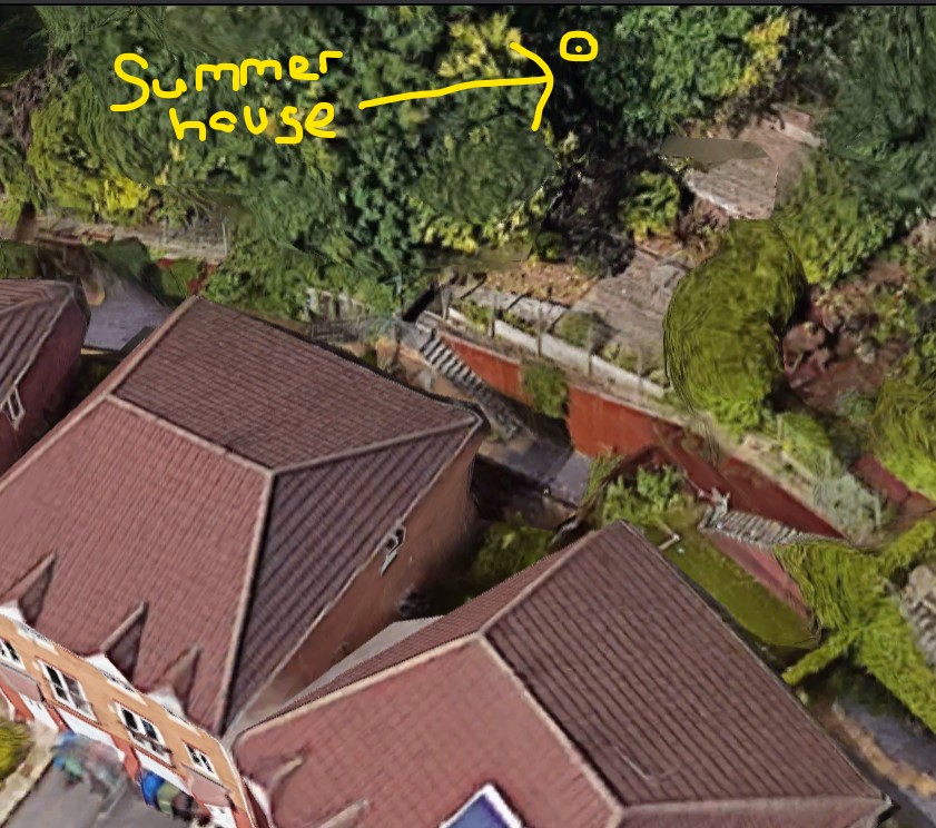

I'm just looking over a job putting power to a summer house but am wondering if anyone has any recommendations on how to lay the cable.
The cable length from the house is 50M going up the house side wall, across a patio, up a 10m wall (onto a balcony garden) then across a balcony garden (through shrubbery and banking up at a 40 degree gradient) to the summer house. The garden is open to the neighbours gardens (so potential trip hazzard / eye sore) and there is a tree in the direct path of the cable meaning roots (so no trench).
I see 3 options: swa on cable tray on posts, t&e in rigid metal conduit on posts, t&e in flexible metal conduit on posts
If anyone has done similar and has an opinion would be appreciated?
