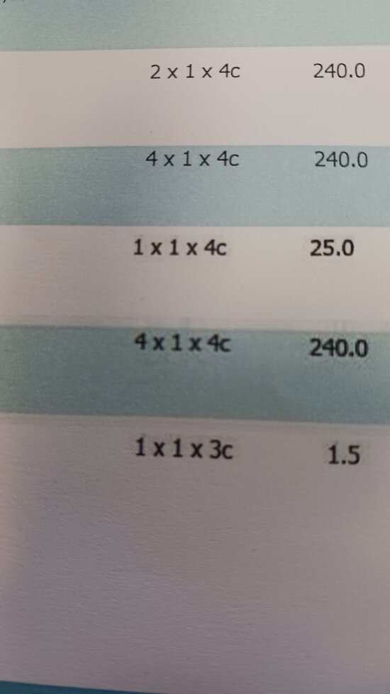

Cable schedules.
Can some body please explain what each digit on this type of info means?
1 x 1 x 4c is one cable with 4 cores
4 x 1 x 4c is 4 cables with 4 cores
I think this is correct but what does the middle digit represent?
Could be a cable size, there should be some explanation on the drawing so it is not ambiguous
James just beat me,
but as above where is that from,
I would read that as
1 of 1mm 4 core
4 of 1mm 4core
But I can't say I've ever seen it written like that, but may be specific to a sector.
Never seen it written like that before, you say it is on a cable schedule what type of cable schedule. A picture would be good.
  • [ElectriciansForums.net] Cable schedules
Is there not a header to the column detailing what it is?
I've not got the sheet with Me today. But from left to right column 1 is circuit number, 2 is circuit reference, 3 is cores ( 1 x 1 x 3c etc), 4 is cable size and 5 is cable type ( which are all XLPE swa).
Column 3 and 4 are in the picture.
