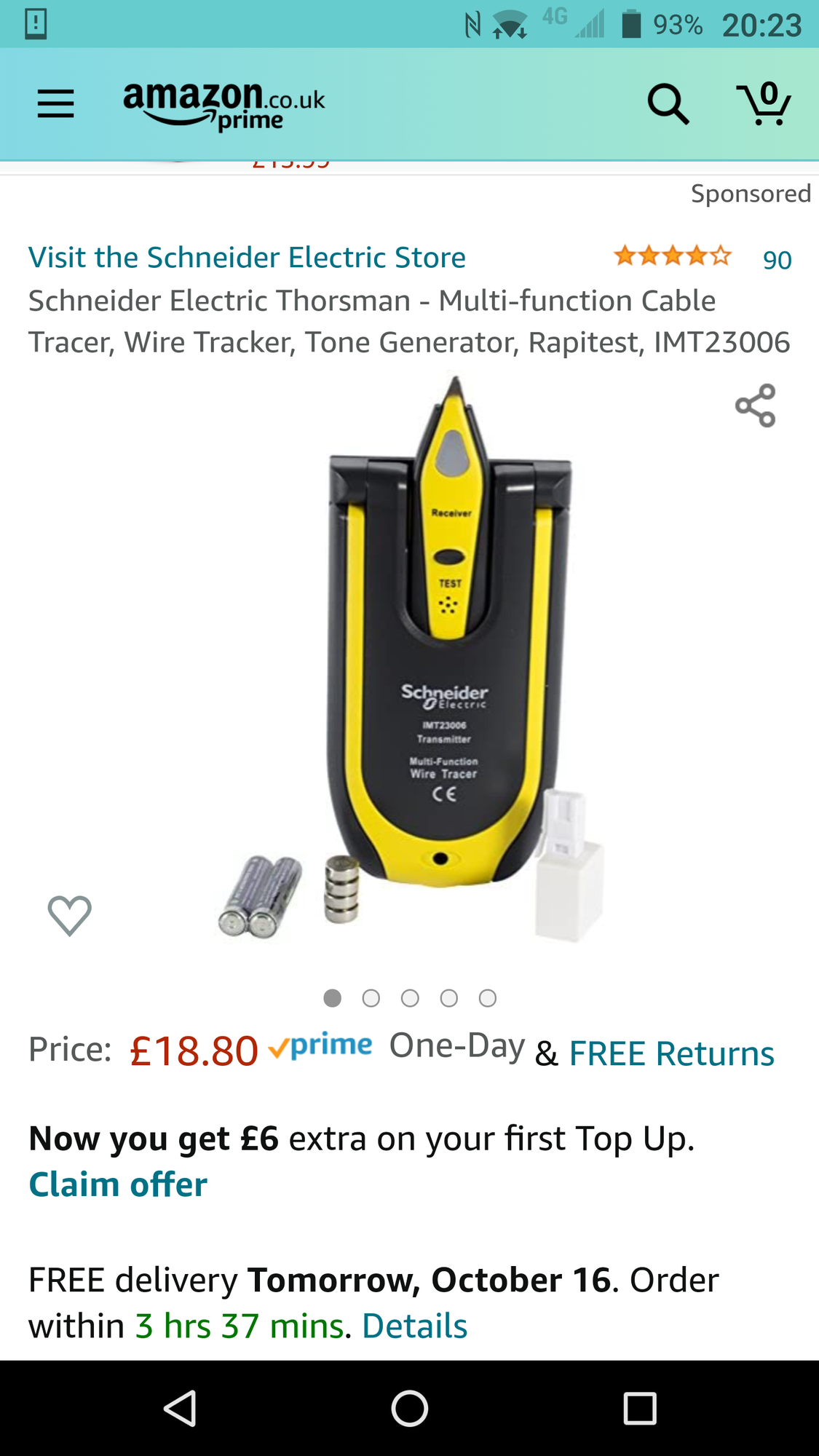

I have one of these, it's actually really good and has had a lot of use over the last year, only bought it because my Maplins one packed up!
Can't seem to get a link for it off Amazon
[ElectriciansForums.net] Cable toner
I must admit I'm not a fan of them either, but they are cheap enough, I bought 50 off eBay for about 3quid when I bought the toner and I've still got about 15-20 left so it's not been a problem.
Don't leave the cheapy cells in equipment or they will likely leak at some point. Keep a regular check on them.
