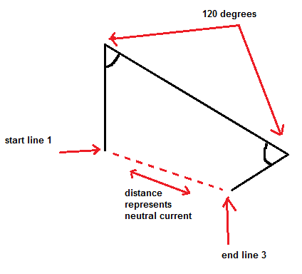

I have been looking at this today and found it interesting so thought i would post a question for any of you to answer.
Calculate the neutral current on a lv 3 phase system.
L1 = 30Amps
L2 = 60Amps
L3 = 22Amps.
SQRT I²A + I²B + I²C - (IA x IB) - (IB x IC) - (IC x IA)
and if the answer is not 42, then i'm out. there's beer to be drunk. but a head guess is 24amps odd.
a rough guess ( and i mean rough) to check if you've don the calc. correctly ( i.e. not got way out) is to add the 3 line currents and divide by 3.
Or a little cheat I like is to use a line measurement representing L1 in cm, then draw a line representing L2 from the end point of line 1 at 120 degrees from line 1, then a third line representing L3 from the end point of line 2 at 120 again. The distance between the end point of line 3 and the start point of line 1 will represent the neutral current. It will look something like this:

p.s. Don't let your college lecturers see you doing this! lol

if you did it in inches, would the neutral current be 2.54 x as large? :rofl:
