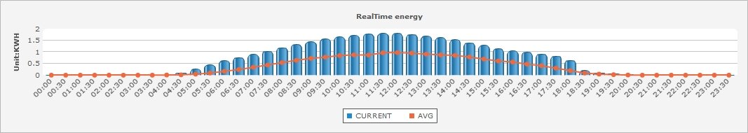

This is a 6kWp east west system we installed a while back on a 3600TL, with 2.5kWp on a steep ESE roof, and 3.5kWp on a shallow WNW roof.
As you can see, it pretty much self limits around the 3.6kWp mark (the figures are for half hourly readings, so double them to get the actual reading)
I'd caution that unless your roofs are relatively steep, I think in peak summer you will be pushing the inverter pretty hard, and the limiting will be reasonably significant (but probably less than 1% of output still), but you're on the right tracks.
