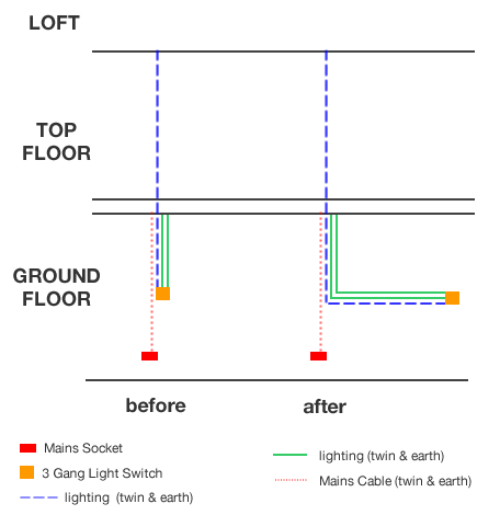

Our entrance hallway to our house annoyingly has a piece of conduit running right down the middle of the wall - it prevents us hanging anything on it and is one of the first things you see. Call me picky, but i'd really like to sink the thing. In the conduit is a mains cable, and three lighting cables that run to a 3 gang switch - so it's pretty packed. The socket sits at the bottom of the coduit and the light switch halfway (see photo). Please excuse the poor photos I had to take them with my phone - as you can see I have started channelling.
I want to keep the socket more-or-less where it is, but move the light switch around a metre to the left so it is next to the door instead of the middle of the wall. However I may not have enough cable for this so imagined I would use a junction box to simply extend the cable by adding new lengths of cable off it. If you look at my attached diagram, the green cables lead to the lighting in the room next door downstairs, and have their own junction box anyway, so I tohught it's not hard to just replace those cables between the siwtch and the junction box. But for the two cables that go upstairs (the mains and a light cable that is the light over the landing), could I use the same junction box for these - say a normal 30A box? They are both the same thickness cable (2.5 from what i can see) - is it okay to use a 30A box for lighting if it is running on thicker cable? Or will I need two seperate boxes to extend these wires?

If your going to the mess and the bother of chasing walls then lets not spoil it by cutting corners, NO jb's just rewire the socket back to its origin and the same for the light switch, dont be putting JB's in unless its complete neccisary
Pm if you need and advice im always appy to help
Looking at the third slide, in the switch id say cables are far too tight and exceed bending factors so again just rewire to neerest point
Hi all - thanks for the fast replies! I agree that chasing walls is a messy pain, but all my walls are brick, and conduit in this area just doesn't look great. I would go back to the source, but it means pulling up a stack of carpets, floorboards etc to get to it. If I did use a junction, would the 30A be fine to use for the lighting and mains, even though it's the same cable diameter? Also, Ezzzekiel & DurhamSparky, what sort of maintence free connections would work well in this situation then where i am sinking in wall? I have never really used any of these before. Thanks!

Also the lighting cable which looks like 2.5mm is more like 3 core.
