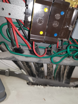

can anyone identify this cable type please | on ElectriciansForums

at first glance i thought it was volcanized rubber but it is tough like PVC and the sheath is much bigger than the cores they are loose inside
[ElectriciansForums.net] can anyone identify this cable type please
We used to call it 'council flat conduit'
Not sure its official name thou
During the 70s modular wiring systems were thought to be the new thing but at the time they never really caught on. Companies like Octopus and Aercon to name a few made it, the idea being it could be prefabricated and concreted in. As Dusty said these systems were common in tower block construction. There are various monikers for them and shotgun tubing could describe yours but I couldn't tell you the exact name or manufacturer.
