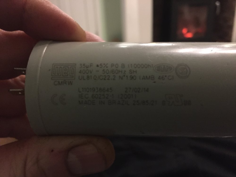

Had a farmer I’ve done some install work for call yesterday saying overload was tripping on his vac pump and could I get some new capacitors ( thought it would be simple enough as changing like for like). When I got there to have a look he said the guy who looks after parlour ( controls etc) had changed the capacitors for 3 new ones, but said they were not the same size and I should get some the same as the originals.
I know the basics of how motor start, motor run capacitors work, but no more than that.

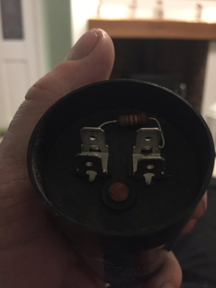

The ones that were taken out ( see pictures) were 2 x 35 micro farad capacitors ( presume for motor run) and 1 x 408 micro farad capacitor with a 15 kilo ohm resistor across it ( motor start).
What I was hoping for was that somebody better educated than myself could tell me;
1 How does bad capacitor cause overload to trip out?
2 Why is there a resistor across the start capacitor?

1. If the capacitor is shorted, open or badly out of tolerance, the motor won't start, in which case the run winding will be in overload, and / or the current through the start winding or leading winding will be excessive and the total will be in overcurrent.
2. To discharge it. Otherwise, if the starting switch opens at a moment in the mains cycle when the capacitor is charged, that charge could remain for a long time if it is in good condition.

Hi Lucien, really appreciate your time to explain.
One final question, how come I haven’t seen a resistor connected to one before? Is it because it’s a higher capacitance or 408 micro farad compared to 35 micro farad. Do I need to do the same to the new one I buy.
Many thanks again.
Some capacitors have the bleeder resistor contained within the can, in which case its presence will usually be shown in the data. A run capacitor on a PSC or CSCR motor theoretically doesn't need one, because the capacitor is always shunted by the windings and discharges into them as soon as the supply is disconnected. Otherwise, yes, the larger the cap the more important it is to have a bleeder. A resistance test will tend to reveal its value once the capacitor has charged to the meter's test voltage and the reading settles.

There are many different technologies used in making capacitors for all kinds of duties, each with different pros and cons. The type usually used for run capacitors consists of long thin strips of plastic film, such as polypropylene, forming the dielectric sandwiched between two conductive foils forming the plates. The strips are rolled up and sealed into the can with one plate connected to each terminal. Different plastics and metallised papers are used in the construction for different performance benefits, but what most film/foil caps have in common is the ability to withstand a significant continuous AC voltage and current without excessive heating, over a long lifespan.
The much higher capacitance required for the start capacitor of a reasonable size motor would require an inconveniently large and expensive film/foil capacitor. An alternative technology, the aluminium electrolytic, packs much higher capacitance into the same size can at moderate cost, but with some significant disadvantages. In an electrolytic, the dielectric is a very thin coating of aluminium oxide on the surface of the foil (only on one foil for a DC capacitor, both for an AC-rated 'non-polarised' one). These layers are permanently in contact with a liquid electrolyte held in a porous separator, that both provides conductivity and electrolytically maintains / repairs the fragile dielectric coating. Many characteristics of electrolytics are inferior to other types, with high leakage, wide tolerance, short life, poor loss tangent etc. They are prone to heating with high currents so in motor start duty tend to have short maximum operation times. Anything that disrupts the dielectric coating can cause a rapid meltdown, whether it is too long a period of operation, overvoltage, too long a period standing disused on the shelf, etc.
Film/foil capacitors do fail, both open and short-circuit, and different types tend to do different things. Your run cap is P0 rated so has no particular protective mechanism and could do either. But electrolytics fail much more often because of their inherent frailties, and when they fail they can be a lot more spectacular, if the electrolyte boils up and the safety pressure vent releases before the thing goes completely S/C.
