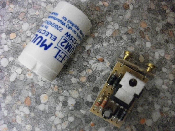

it will be the tube, the lamp/bulb will be fine if its brand new, it will just need shoogled about a bit to make sure the contact between the pins and the holder is good.....the 2 blinks then nothing is just what the electronic starter does (its a chip based starter with no glass inside) it strikes twice then disconnects to stop a fitting from just blinking over and over......
Electronic Ballasts do this and the new replacement Electronic starters do this as well, if you put in an older style starter it will just blink over and over....
