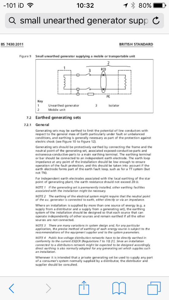

Slurps, refer to bs7430. Section 7.1.4 describes an unearthed generator supplying a mobile or transportable unit. It would appear to describe an arrangement similar to your allowance with an earth / neutral link at the generator. It also suggests an earth electrode should be connected to the main earthing terminal with a resistance sufficiently low to operate rcd s. Consider a value below 200 ohms in this instance ref. Bs 7671 415.5.3. I'll try to attach wiring diagram from relevant bs (if I'm allowed)?!
