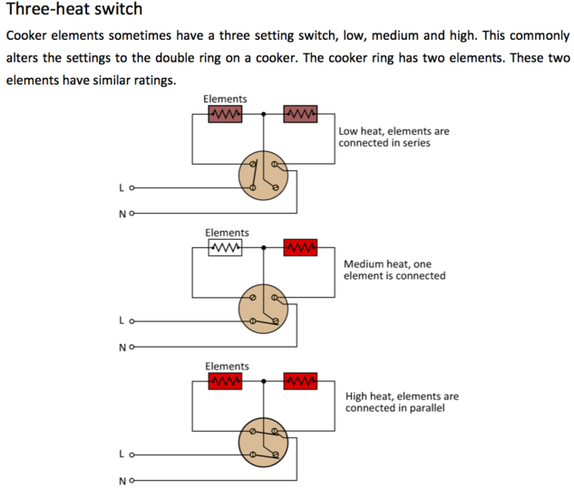

Okay, this was a thread that was posted in the main forum. The guy has 8 heaters which are cabled to a control panel where they are switched on and off by contactors.
The control panel is supplied with a 3-phase supply from a local DB and each heater is protected individually by a 16A MCB.
His problem is that the heaters have been cracking because of the rapid temperature change during start up. He was thinking about installing dimmers in order to manually heat them up slower over several minutes by gradually turning the dimmer higher. Problem is that 16A dimmers will cost an arm and a leg so I suggested to him that it would be possible to install some extra contactors and a timer. The heaters would then be grouped in two's and each group would start wired in series so each heater only gets 115v and after several minutes the timer causes contactors to change the wiring so each heater is supplied individually again as they are now.

How many kW are the heaters. You could use a dimmer but you're possibly getting into the realms of very large dimmers which will be expensive. Depending on the layout maybe you could could use something similar to a star/delta starter to first switch them on in groups of two in series connection so they only get half voltage, then after a few minutes it changes over so they're back to standard supply voltage. Just a thought, how easy this would be would depend on the existing switching arrangement, if they're not switched from a central location t might not be viable.

There’s a way of building up the heat that we used on analytical ovens (1600°C). By connecting the elements in various series parallel networks the power is regulated during start up. But as Marvo said, if the feeds to the various elements aren’t taken to a central point it wouldn’t be viable.
The switching won’t be cheap but the system is reliable. It comes down to what the failures are costing.

If all the heaters are individually supplied from one control panel and as long as all the neutrals are there as well then with a couple of contactors and a timer you could feasibly reconfigure them to start up in pairs supplied in series so they'd be at half voltage for a few minutes then change over to them being individually supplied after a few minutes. I'm sure this would be a lot cheaper than sourcing 16Amp dimmers and less complicated for the user as well.
This reminds me of a cooker/hob switch I came across in my course notes:
[ElectriciansForums.net] Ceramic heaters
Maybe the middle diagram isn't so relevant (unless you only wanted to put half the heaters on), but the top and bottom ones sound like what you're describing.
I'll just leave that dangling, I've been doing assignments all weekend and now I'm tired...
Absolutely spot on Steve, I like the way you're thinking. The cooker switch is a very good illustration of what I was suggesting the OP does with contactors and as you say the middle diagram wouldn't apply in this case, only the first and last one.
