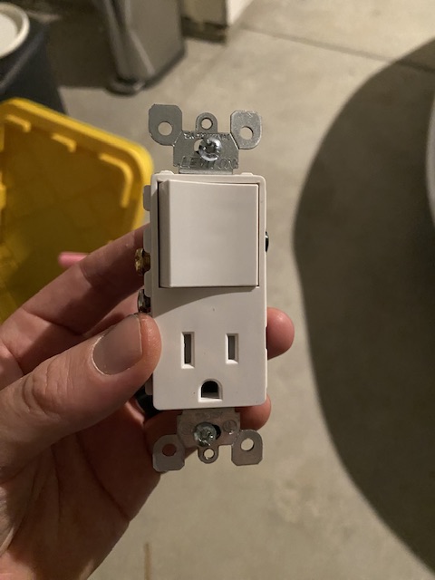

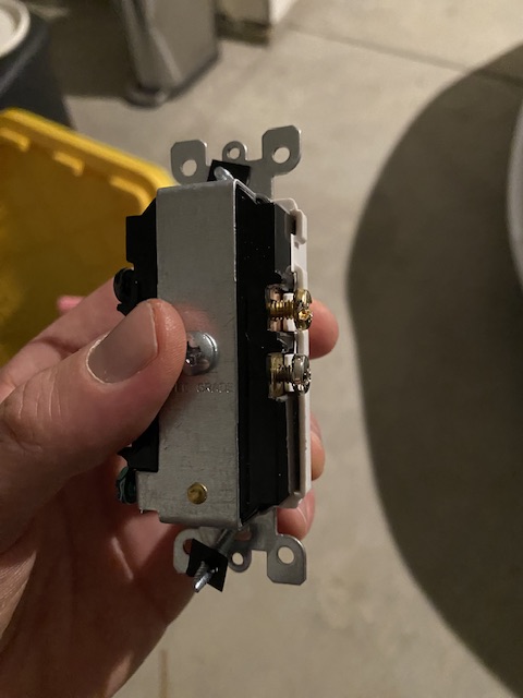

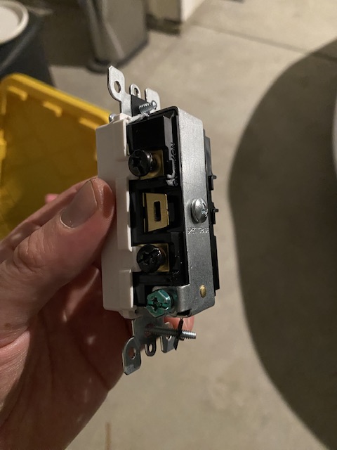

Hey all - I’m trying to change out a switch only with a combo switch/outlet. After doing the wiring everything seemed to be working but I then realized that the switch also turned off the outlet? Is that normal behavior or did I get my wiring crossed? The combo I’m trying to install has a the standard ground, hot, neutral, and then 2 common (with a thing in the middle that says to break if using 2 circuits.) ideally I’d like a switch and an outlet that operate independtly.

Sorry bad order of pics - but this is the switch I’m trying to replace and the combo I’m trying to install.
I can tell you that the 2 black screws are for the switch and the gold and silver screws are for the receptacle. I hope this helps and welcome to the forum.

You actually need to use the light switch since that’s where the lights are controlled from. The red wires should be your travelers going to...
976
The best and easiest way to do it would be turn off the power and take the light switch out and splice the 2 wires on the switch together. Your...
